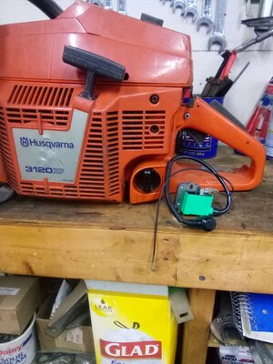

Hey guys, anybody else have a problem with the husky 3120 burning up coils?

Well, new coil, yanked flywheel to look at key and keyway, still no sparkles.
What in the ...? Never had that happen! Yes, I am looking now for a OEM coil.
Thats what I get for shopping over seas. Where should I send money?
Yup , can’t beat OEM , especially ignition items ,
4:23 AM
11,589
44,141
Spark plugs!?
Something about non-resistor plugs damaging ignition elements if these are set up to run a plug with resistor.
Just a thought.
Might be worth checking/looking into since plugs are cheaper than coils.

Leave the kill switch unhooked and see if you have spark again
Kill switch un hooked and still no sparkles, what a treat to hook that back up. bent needle nose pilers and still 5 minutes to get it plugged back together. I guess i am not supposed to work on orange saws.

Hey guys, reset the air gap and I got sparkles.have a video but the
Forum don't accept it. And yes Wilhelm, I may have dropped some bombs
In the garage tonite but it all went away as soon as that big girl barked off.

What color coil did that saw come with new?
