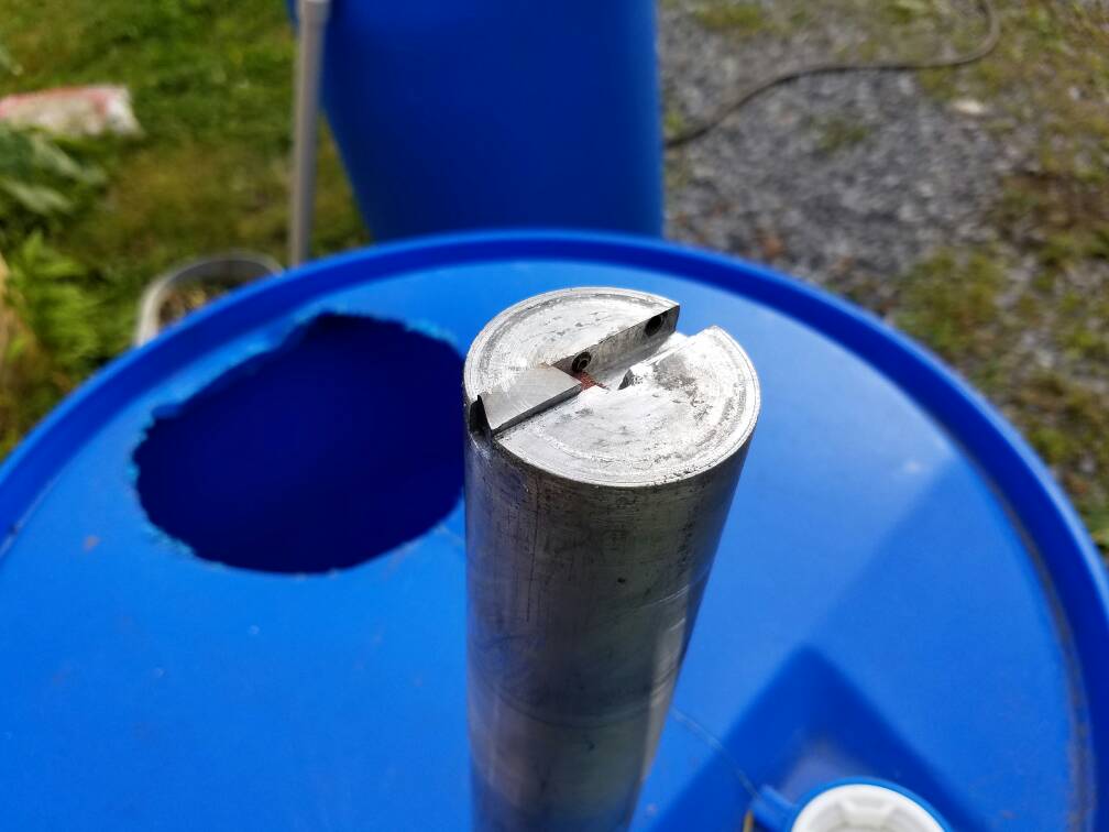

You stated base earlier Tony.
Does the mandrel that you cut to do your base have a nice square face?
Use adhesive backed sandpaper on it and sand the band flat. Go finer and finer.
As a last step, lay your cutting mandrel flat on your bench with the cutter sticking up and gently ream the edge.

Not being able to get it perfect in a timely manner is why I cut by hand. You could have easily cut the .040" out by hand in the time you messed around trying to dial it in.
The first one on my lathe took about 45 minutes to center the fixture and then the jug.
It only takes me about 10 minutes each jug now, but I have 2 indicators in the bore, one at the base, and one at the top, above the exhaust port
So can cutting the squish be done well just by sanding?
I noticed cutting mandrels mentioned?
By hand would suit me!
You slot the top of your mandrel and affix a HSS cutter, then turn the jug by hand while the mandrel is held in a vise
If I were in your shoes, I'd stick with what Al suggested; and use self adhesive sandpaper, like you get for auto body repair work
