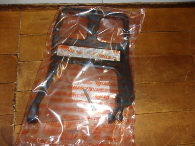

Hey everyone I have a saw that was gifted to me by one of my grandpa's good childhood friends. The saw kinda has alot of sentimental value. Trying to get the saw put back together. It was his falling saw back in the 80's and 90's. He had removed the brake and has no idea where it might be. If anyone might have a lead on a brake for a 064 Part # 1122-792-9105 please let me know I would love to buy one. Thanks alot.

Yeah I have been watching ebay no luck so far for my part#.
If nothing else comes up, you can use 1122 792 9106 and then run a spacer on the starter side.
9106 is the 066 brake handle - it's a little wider but usually easier to come by.
Nice. Thanks alot appreciate that tip. I will make a note of that and start looking. Just checked ebay. As of now nothing available. At least it increases my chances of finding something.

It has the old 3/4 wrap handle ?
you need the 9105
Or get a newer 3/4 wrap and use the 1/2 wrap brake flag
you need the 9105
Do you have the part #'s for the different wraps? And the part number for the new flag I would need with the newer wrap?
