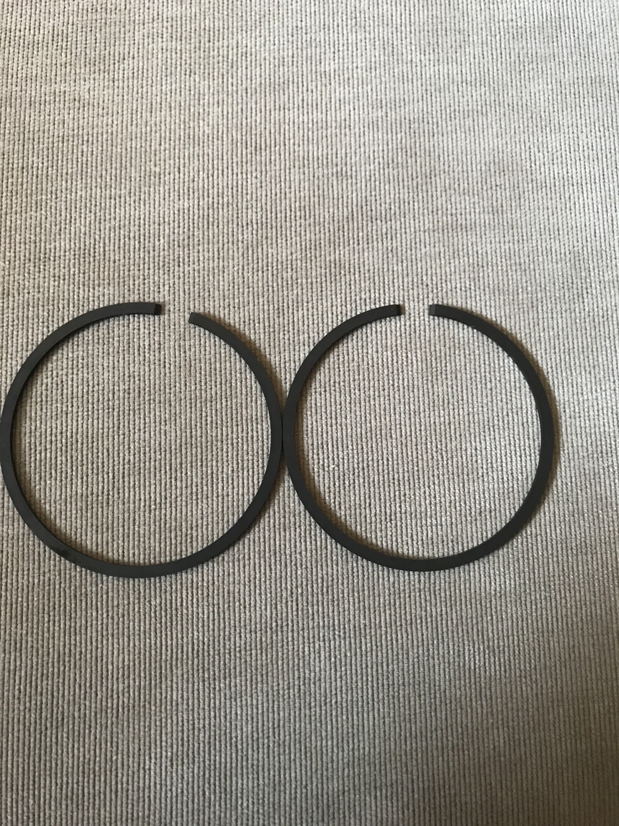

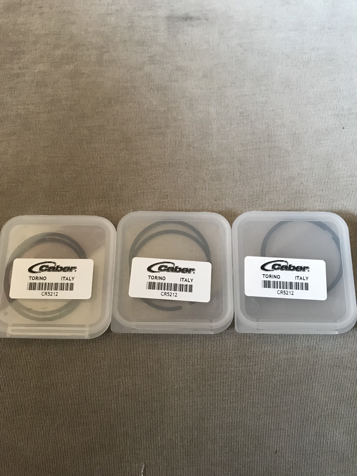

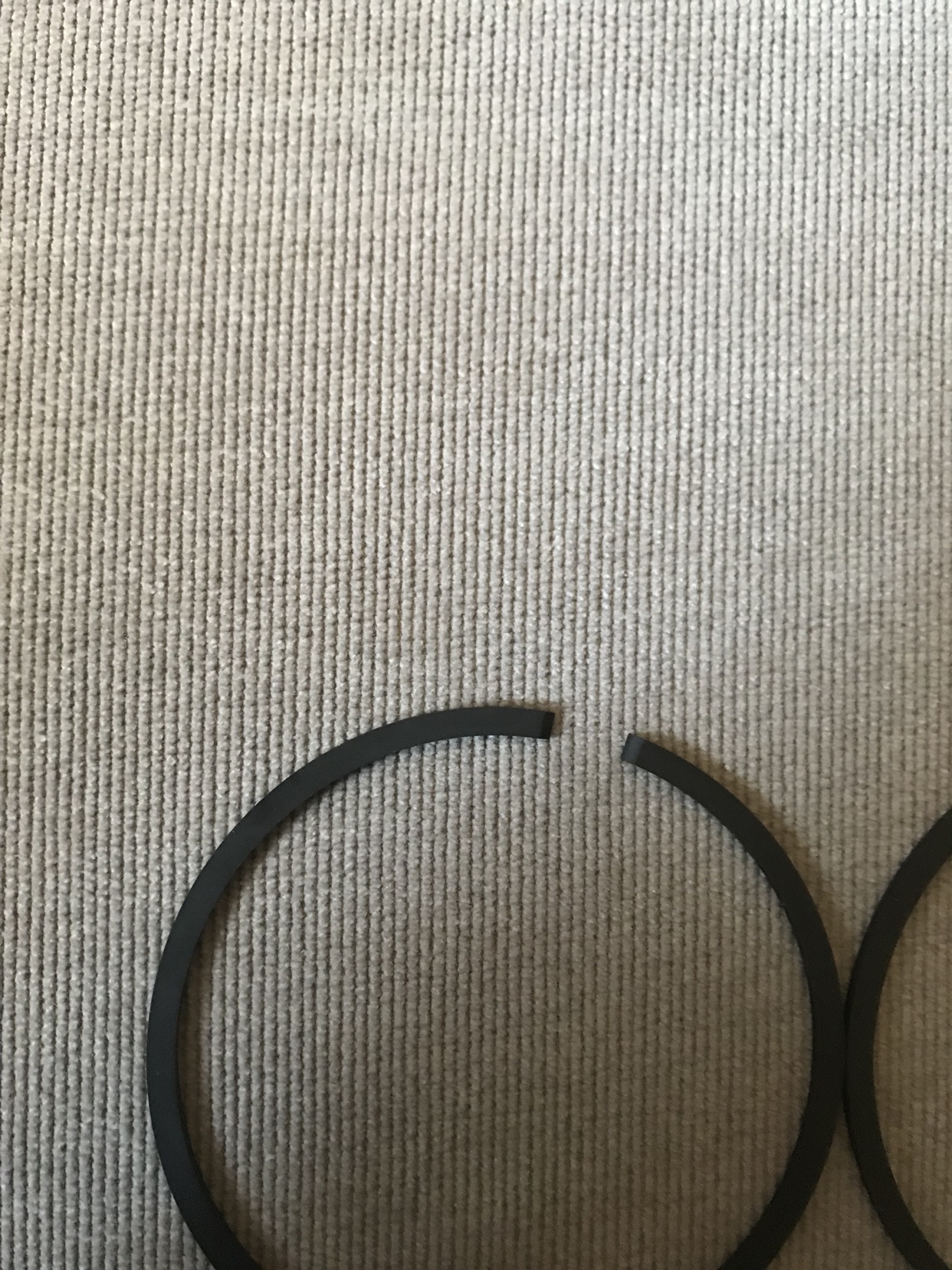

I ordered these from HLsupply. I’m kinda confused all of my other caber rings appear to be oil coated and have caber laser etched on the top of the rings but these are black and no etching... did I get duped?

I sent an email and pictures they’re checking into it I guess there are some older Caber rings that were black with no etching they’re going to confirm that they are Ledgit even the highway rains that came with the Pistons I got were cleaner looking in then these

AE2DBD5C-6F06-4E6E-A6E7-D325DD14C749.jpeg I’ve had the same thing happen, purchased multiple sets of the same rings, some came stamped caber, some black with no markings. All were in caber packaging with same part numbers.
I never did figure anything out.

The non f cast cabers are pretty dark like that and aren't marked.
Those look like they could easily be cabers, need a closeup pic of the ring edges to be reasonably sure.
This is the easiest way to tell they're caber, the machine marks and more importantly, the beveled edges.

I remember looking close up and I don’t remember seeing those marks. I’ll check again tomorrow with a magnifier and see if they are there. I bought 3 sets. So if they are not I guess I was duped three times at one shot. If they say “whoops we will send you some new ones it seems packaging is messed up” I would only question how many people paid double the cheap price for caber rings and got the cheap rings...
