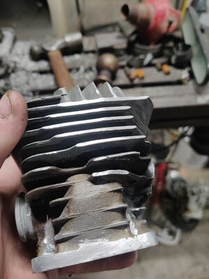

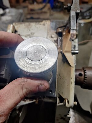

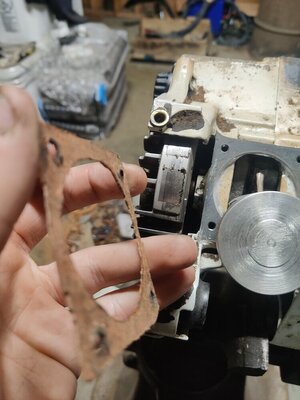

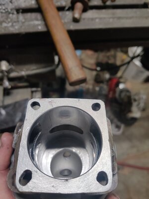

Finally got back on this project after several others. Port timing stock ended up at 73 120 103. I made a gasket out of 1/16 gasket material and chopped the top of the piston into a very small popup.IMG_20230420_115708.jpgIMG_20230420_115741.jpg
Then took .025 off the band and base. Might could use a shorter single ring piston to avoid machining it for clearance but I didn't feel like it.
After all the cutting and grinding I ended up with 79 121 102 and .025 for squish for now I'm going to leave it since the chamber is a D shape I would like to keep it between 185-195psi. Still need to clean up some rough edges but the main work is done.IMG_20230420_115931.jpg
Quite a bit of grinding on the cylinder to make it fit under the plastics also drilled a hole for a husky decomp. I'm young but lazy when it comes to starting high comp saws. Also ditched the old cracked 034 cover in favor of a 036 pro cover.IMG_20230420_115806.jpg

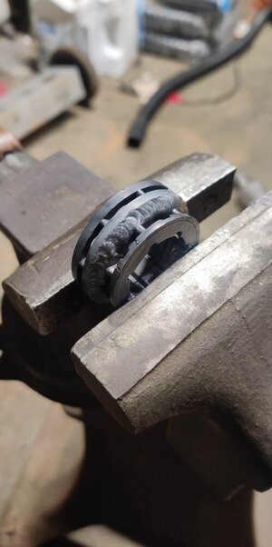

Got back on this yesterday and finished it up. Appearantly the 044 crank has a slightly shorter pto side Wich made for this interesting contraption and cutting some off the clutch drum. I need to bore the center out so I can put a washer and snap ring on it. It is a 325 9 pin welded tona 3/8 7 if I was to run 3/8 I would pretty much have to run a 8 pin and weld that to a 7 still needs a little machined off to be inline with the bar. Also had to shave down the oil pump worm gear so the clutch wouldn't hit it.received_654646423456345.jpeg

Interesting project. The 044 drum is same size as the 360 drum, just shallower. You just need the larger drum bearing.
The 360 crank does have a longer PTO side crank than the 044.
I like how you solved the depth problem.

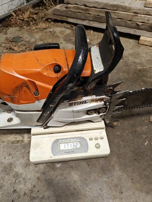

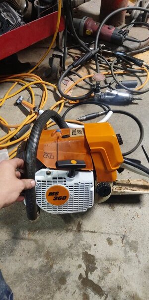

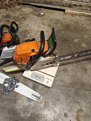

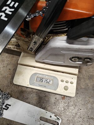

This thing is super lightweight too. I have weighed it partially filled with fluids and a 3/8 20" tsumara premium light bar vs my 261 with a 261 325 sugi light bar that is almost empty on both fluids. And then my 462 with a 20" 3/8 also mostly empty on fluids. The 034 does not have dogs on it yet but it's close enough to say it's the same or close to the 261. When both are filled.
I will try to get a video in a few days when it isn't raining a flood.
