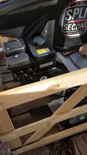

Got mine in the middle of October 2018. This thing sips fuel slower than the Honda did. I’d run through fire & hot coals before I would buy anything else. This thing is absolutely amazing !!!!View attachment 364460
I decided on the Honda GX on my SS HD when I bought it. From everything I’ve read and heard, I would’ve been just as satisfied and save a little coin going the Subaru Robin route. Good to hear it’s Cadillac’n right along.
