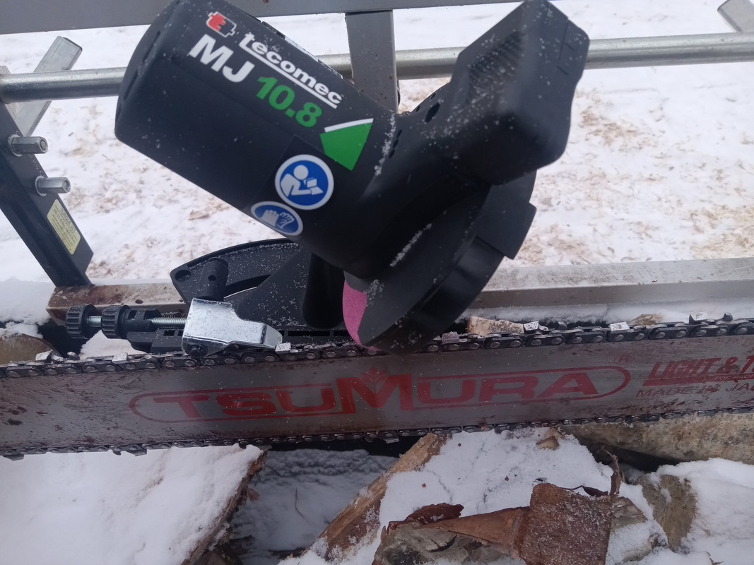

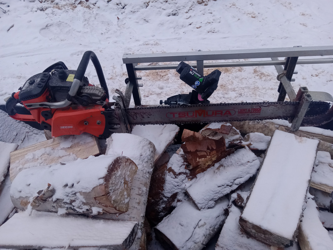

Regarding sharpening, tecomec makes a nice lithium battery chain grinder. It uses the same grinder wheels as a typical grinder. Mounts right to the bar, which is really nice because u don't have to remove the mill frame. Or remove the chain. In my opinion, it's the first "legitimate" portable chain grinder. Sure does hold a 10 degree angle better than I can:

Here yah go Dan:
