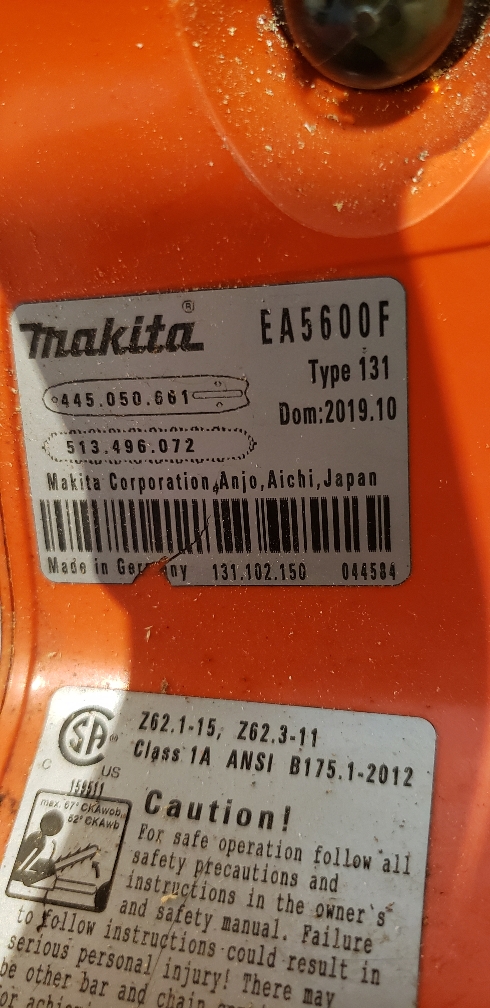

Good day, wanted to reach out to some folks on this page to discuss what diagnostic/improvements I should put on a list for this saw. It came from Home Depot's Tool Rental dept and ran when I picked it up. Seemed like it was kept up alright, but im fully aware the "pile" that rental machines can be put through. Should I bother with a tear it down and rebuild due to the unknown # of hours on it? Thanks for any/all thoughts. Thanks also to Paragon Builder for your review a couple years back!

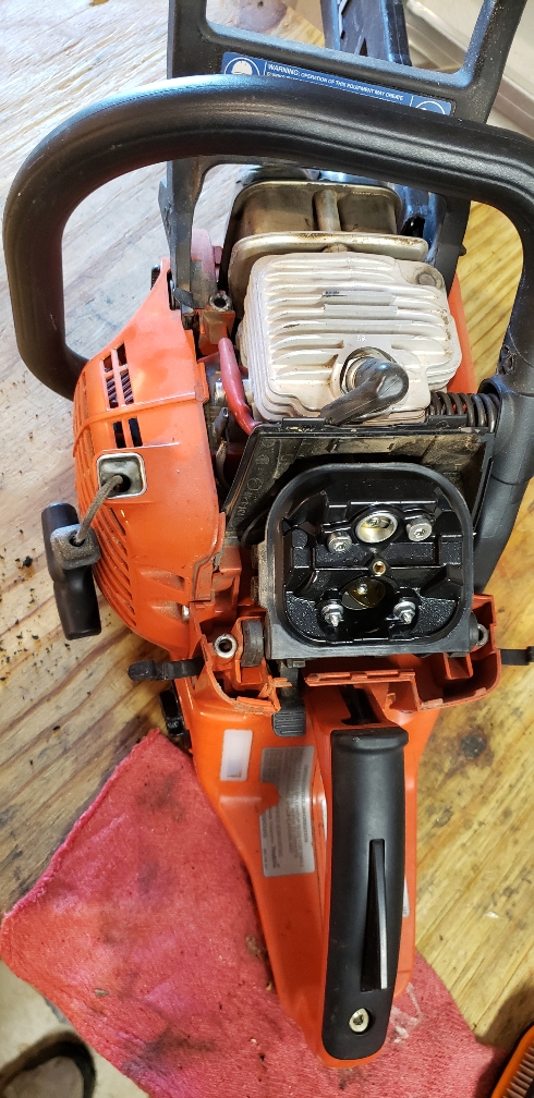

Plug was nicely toned for a 2-stroke. Filter was clean. Being this saw is only a year and some old, I think it's in fairly good shape. Honestly the pull start is the only flaw I could find. I did reset it on the rotor, but once I started it up again, it hung out like that. Is this a known issue?

Sounds like somebody yanked the crud out of it, mebbe pulled some tension out of the spring. If that is as bad as it gets, I would just pull the rope up through the handle, cut off the extra length, and tie a new knot. Do keep us updated on how well this saw runs, it may turn out to be the last Dolmar design ever.
