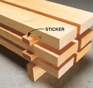

I am gearing up to start milling and bloody hell, there is some prep and gear needed.
I have space to sticker the slabs, but I need to get all the spacing timber ready, something to cover it and cinder blocks.
Hell.... I have cut so much firewood I could use that as weight
What do people use as spacers?

Typically the same wood as you are milling, if possible. Sometimes differing species will "stain" wood as it sticks drying.
Edit. If it's just lumber it don't matter, if it's furniture grade milling then staining matters.

Use the wane you cut off the end of the boards for stickers ,i have had boards warp when i mill them an hour after i fall them ,the longer you let them dry the harder the wood gets,softwoods cam be down a year and mill ok still

Here is what i sticker with ,just scraps off the sides ,so they are 1.5 thick and flat on 3 sides
Around here if i do not sticker the boards and just stack them ,the saw dust molds real fast and stains the boards .
