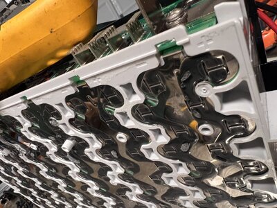

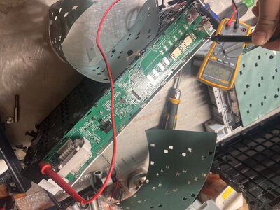

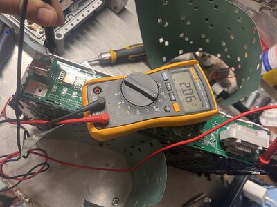

I cannot even test individual cells, they’re covered at the tops with some type of epoxy. I would like to test each one. For now I’ve come up with test each top connected to circuits board giving me these readings.
JD22
1:42 PM
22364
Jan 20, 2022
159
216
California
Forgive me for being such a Noob.
Forgive me too, I have never taken a riding lawn mower battery pack apart.
With these pictures, I see what I think are factory test points. I am going to draw on your photos and upload them and tell you how to test with a DMM and how to charge the individual packs. It will be later tonight, I just came in to check my e-mail, I still have work to do before it gets dark.
I just wanted you to know I now think it is doable.
