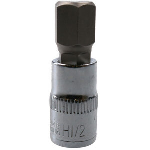

You need a 1/4 hex drive adapter to either 3/8 or 1/2 square, like this:
And then a 1/2 hex bit with either a 3/8 or 1/2 square drive to match, like this:
Best if both items are impact rated.

I did look for a 1/2 hex 1/4 hex drive bit that would fit directly into the chuck of your impact driver. But cannot find one.
The nearest I could find is this 12mm hex 1/4 hex drive Milwaukee bit. 12mm is almost 1/2 inch but it would be slightly loose and probably would wallow the socket in the head of the bolt.

I picked up a 1/2" socket head set locally (pittsburg brand $14) that gives me the 1/2" hex and I had a 1/4" to 1/2" impact adapter thing, so all set. Hadn't seen a single 1/2" socket head hex thing anywhere else- which was really my question. And I didn't want to buy a $99 impact rated set.

eh i was just lazy... found it... 5 dorra...
maybe i'll find one that's impact rated, unless i get a bunch of OCD responses how I can't use this and I gotta get an impact rated one, then I'm definitely getting this and then uploading youtube vid of me using it with my impact drill :)
