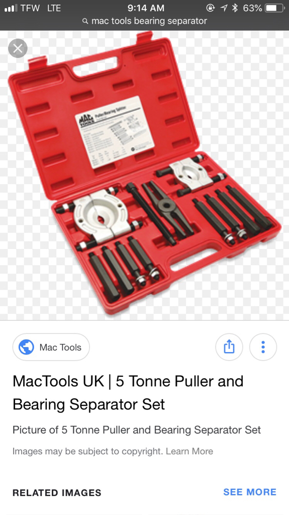

And would a simple clam shell bearing separator something like this work?

The MS250 is a clam shell design. The whole saw has to be disassembled to replace the crank bearings. (Many guys hate the clam shell saws like the 250 -- I really don't mind them at all).
You can use a bearing separator like you have pictured or a simple 2 jaw puller to remove the bearings from the crank with a small 12v type impact. Done it many times.

I use one of these.
