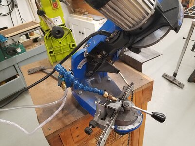

I have both Diamond Wheels and Foleys brand CBN wheels, I leave a Diamond Wheels brand 1/8" wheel in one grinder for .325 and 3/8 LP chain, and a Foleys brand 3/16" wheel in another grinder for full 3/8 and .404 chain. The Diamond Wheels brand wheels are aluminum and a very fine grit, the Foleys brand wheels are steel (heavier) and have a reasonably coarse grit compared to the Diamond Wheels brand. Many of the chains that I sharpen (for others) are in pretty bad shape so the CBN wheels hold up extremely well and tend to produce less heat while grinding. Even so, I have set up a Kool Mist device and have been using air & water on the cutters while grinding. There is actually very little water sprayed on the teeth while grinding to keep them cool so the mess is minimal.
Others will have different opinions but I can't imagine ever using a vitrified abrasive wheel again.
FWIW, I also have a Diamond Wheels brand diamond grit wheel for sharpening carbide chains...it gets very little use.

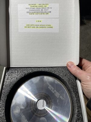

Who's using CBN grinding wheels and what have you found to be the best? Looking to grab one for my grinder.
Thanks
Dan
I have been using CBN wheels for 3-4 years and would consider no other wheel after using them. The diameter and profile don't change like vitrified abrasive wheels do. The claim is that they are good for a thousand sharpenings, and I believe it.
I got them where Woodpecker got his. My grinder is a Stihl brand with a rather small shaft diameter (12mm). Seems that many/most grinders have a much larger shaft diameter (7/8"). But that company had a lot of options as I recall.
They are expensive, but I don't think you would regret having them. Regards, Brian
