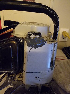

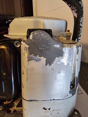

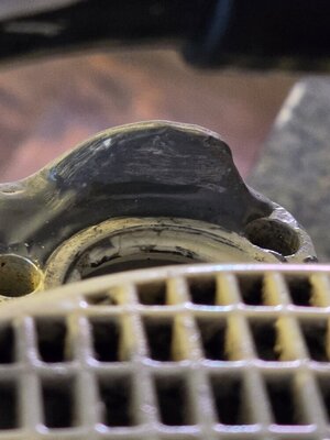

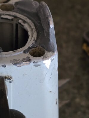

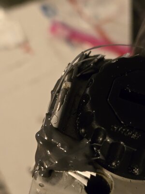

while back I posted bout myb066 cracked oil tank. It was dropped during shipping and cracked the tab confront of the oil cap and it leaked severely. It was cracked all around. I acetone cleaned the area. Ditch cut it and cleaned it up good with acetone good. I used jb weld with some fiberglass cloth
