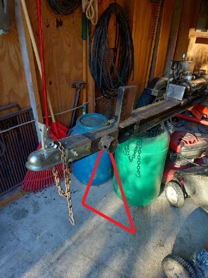

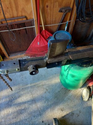

I'm looking for some ideas on a jack stand for my wood splitter.
I had a side mount crank style on it and it gets in the way of the log coming off the wedge .
Also had a drop leg on the underside of the beam and that wasn't sturdy enough.
Id like to have a stand that's sturdy enough when I'm spitting wood and not to have to prop it up on a log while in use .
Anyone have an idea ?
Thanks
Ernie

maybe weld an automotive scissor jack to the bottom of the tongue, than stuff a round under there and use the jack to level it off, at least than everything is on the underside.

If you unbolt the hitch, find some square tube to weld a ?piece of 2-1/2" " sq. tube vertically with holes (5/8"maybe 9/16") one on each side (for a 1/2" pin to go through) then a leg would telescope/slide up or down in the 2-1/2" tube with multiple holes in it for height adjustment; (this square tube would be 2"x2" (1/4 " wall) and 30" or 40" long (tall) a foot/plate or trailer swivel wheel on the bottom. Then weld a stub for the hitch to bolt or weld on then and weld the 2-1/2" piece to the tongue that the hitch was welded to. Maybe before you weld it decide if you would like to raise or lower the ball hitch if so weld a piece of 2" or 2-1/2" tube so you could weld that under or over the existing tongue and have an easier position to get a nice weld. Use 2" if you want to raise the hitch, 2-1/2" or 3" piece if you want to lower it. The 2" adjustable leg would be centered behind the wedge so shouldn't interfere with splitting. Raise the 2" leg all the way up and have a hole to put a pin through to keep it up for transport. Just remember the tongue will be heavier .
Easier to explain with a paper and pencil and a barley pop in the conversation.
I like the idea but I think it would be a hassle carrying around the jack stand and have to lift the splitter to get it on the stand .
Thanks

your crank jack would still do that then pull the pin and toss it out of the way. I understand your concerns. It looks like your splitter is a bit hitch heavy.

Do you own a welder?
If yes, weld up a flip over stand like this. Make it long/tall enough and forward enough to flip over the front hitch mount and flip over the wedge to lay on the bed of the splitter when towing. Attach it on each side like the flip over jack with a pin on each side to lock it in place. I guy at my hunting club has a set up like that and it works great.....wish I have a real picture of it
That's a great idea ....i do own a welder and I can make something like that.
Id definitely help to see a pic of the locking mechanism.
But I can maybe figure it out .....
Thanks very much
Ernie

The way he locked it was the same as the jack u have on the splitter now. He just said that he learned the hard way to put the pins in horizontal cuz logs catch them if they are in vertically, and then get bent.
He also said he may in the future mod it to come off, but as of now it is welded on in one piece that spins free on the side mounts unless pinned.
It is pretty slick, he unhooks from the truck and lifts the splitter up till it’s near balanced on the back wheels. Then flips the stand over and puts a pin in, lets it down and puts in the pin for the other side. He also said the only issue is on very uneven ground. Then a single point of contact in the ground would be better.
