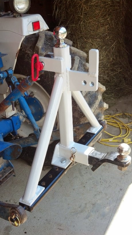

After seeing the winch set up in the post oak or white oak thread I'd like to mount mine like that to this tractor.
I'm thinking that 1" slot above the yard stick would be the place.
A plate with 3 holes with a Reese receiver welded to it.
Does Ford or Reese make such a gadget?
Am I thinking straight here? Any help appreciated.
When I search this I get a fuzilion F250 hits lol.

I've used this setup a lot for skidding logs. You could easily mount your winch in the receiver.

That's probably how I'll go.
I see those online but not in person yet.
Wanted it low on the chassis but fit room is not cooperating.
I have a plan for a front mount, welded to the weight box, waiting for welder guy to stop by and approve. Thanks.

Other than the draw bar, I built that one out of stuff I had. It's great for moving trailers as well as in the woods. I use it all the time.
