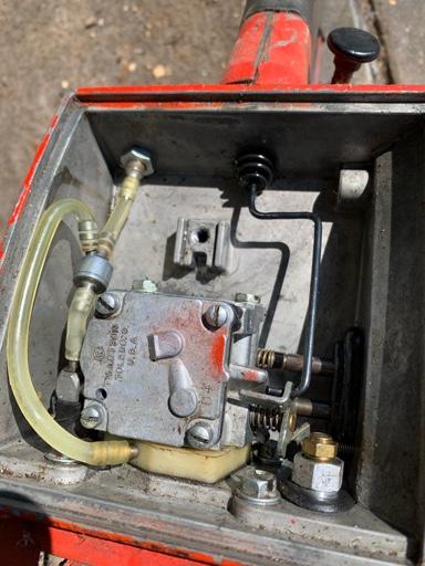

I have a Remington PL-7, with a wonky primer bulb starting system.
It’s not working right and sucking extra fuel thru the primer lines.
It a HS75 or 751 but I can’t read all the number.
Anybody got a recommendation what Tilly w/blade choke will match the flow capacity?
The Remy is like 95cc.
I’m done fooling with the Mickey Mouse primer.

I’m the meantime, I plugged off the primer circuit.
Old turd runs good. [emoji3526]

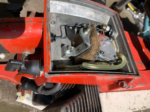

I bought a couple of the Chinese ones to modify.

Got one in the mail today. Looks like it will work with a throttle shaft change. Choke is good to go.
H&L jet screws are different (thread pitch and short) but a simple plug in the carb box access hole will solve that. Cant be letting trash bypass the air filter.
