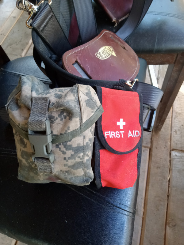

The first aid pouch is useless in size and doesn't have a snap to hold the important stuff in pouch when walkin through brush. Found my tourniquet tangled in a brush pile.
I ended up affixing my medical pouch I pulled off my ballistic vest from 3rd deployment in Iraq. That's an actual medical kit with sufficient size for the bare minimum medical stuff. It also won't accidentally open.

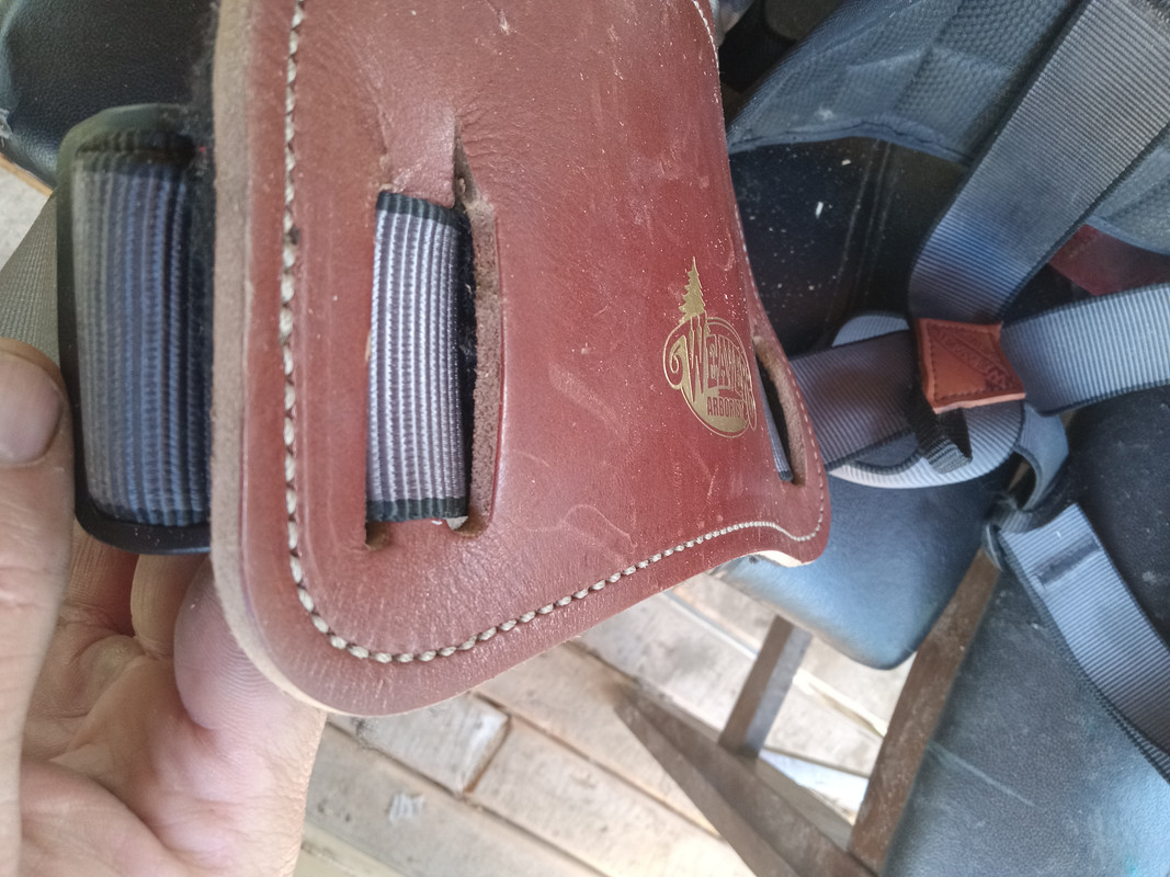

To install a leather patch fer carrying yer saw on yer shoulder, you have to cut the slits wider, it won't fit over the buckles. Should've came with this to begin with.

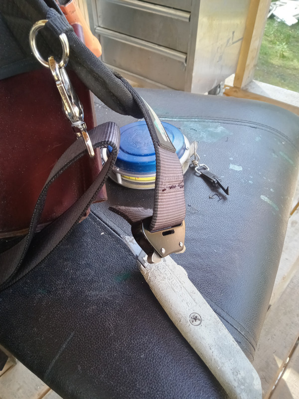

I chose to cut the threads on the left buckle, as the thin thread needs to be redone with thicker leather type thread. It was frayed from the buckle coming contact with abrasive bark from carrying branches or resting yer stomach against a log.
