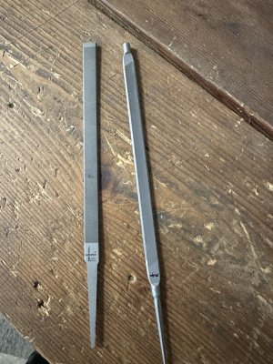

Triangle files are usually available through stihl and are quite a bit cheaper. Single bevel is ok but they are known to flex a little bit since they are thinner
I’ll be damned! You’re right, a single bit is more flexible. I will say when I was starting out a single bevel was a bit easier for me to keep my corner lined up than a double bevel. Others mileage may vary but that was my experience with a single bevel. The triangle is very flexible and I’ve yet to master that one.

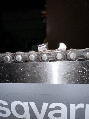

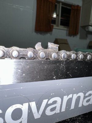

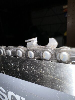

I can usually nail the top corner pretty easily, but I struggle getting the “bottom corner” of that line straight through the crease of the cutter. Also it’s hard to judge side plate angle while filing, lots of stopping to check and then filing some more. Any tips are most welcome.

Your cutters look ok and you have the right idea. It’s hard to make both corners line up with a file and still produce a chain for firewooding rather than racing as the chassis gets in the way as you file more downward.
I wouldn’t worry about the top plate angle. The file shape isn’t adjustable so you can only make 2 of the 3 angles how you want them. Get your down angle where you want so the cutter is durable, and get the side plate angle where you want it (between 0 and 5° forward lean or so) so that the chain self-feeds with .025” rakers. (More forward lean makes them more aggressive). And your top plate angle will end up where it ends up. Usually between 15 and 20°.
