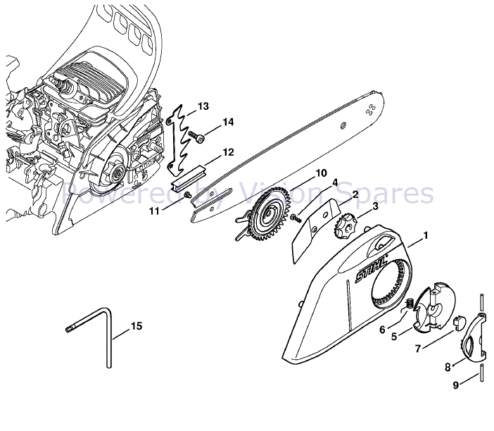

I have that aluminum block. Shows number 12 in your ipl
Michael,
That aluminum block, item number 12 in the drawing, would save DIY-ing one out of maple or walnut.

It is light and small. I will send it in a padded envelope and think $5.00 would cover it for sure plus $3.00 for the part and you are good to go. Mike

Put in another $4.00 and I will include the two screws you need. Mike
Might be overlooking something, but believe that's remainder of parts necessary in converting MS 170 to Quick Change...
