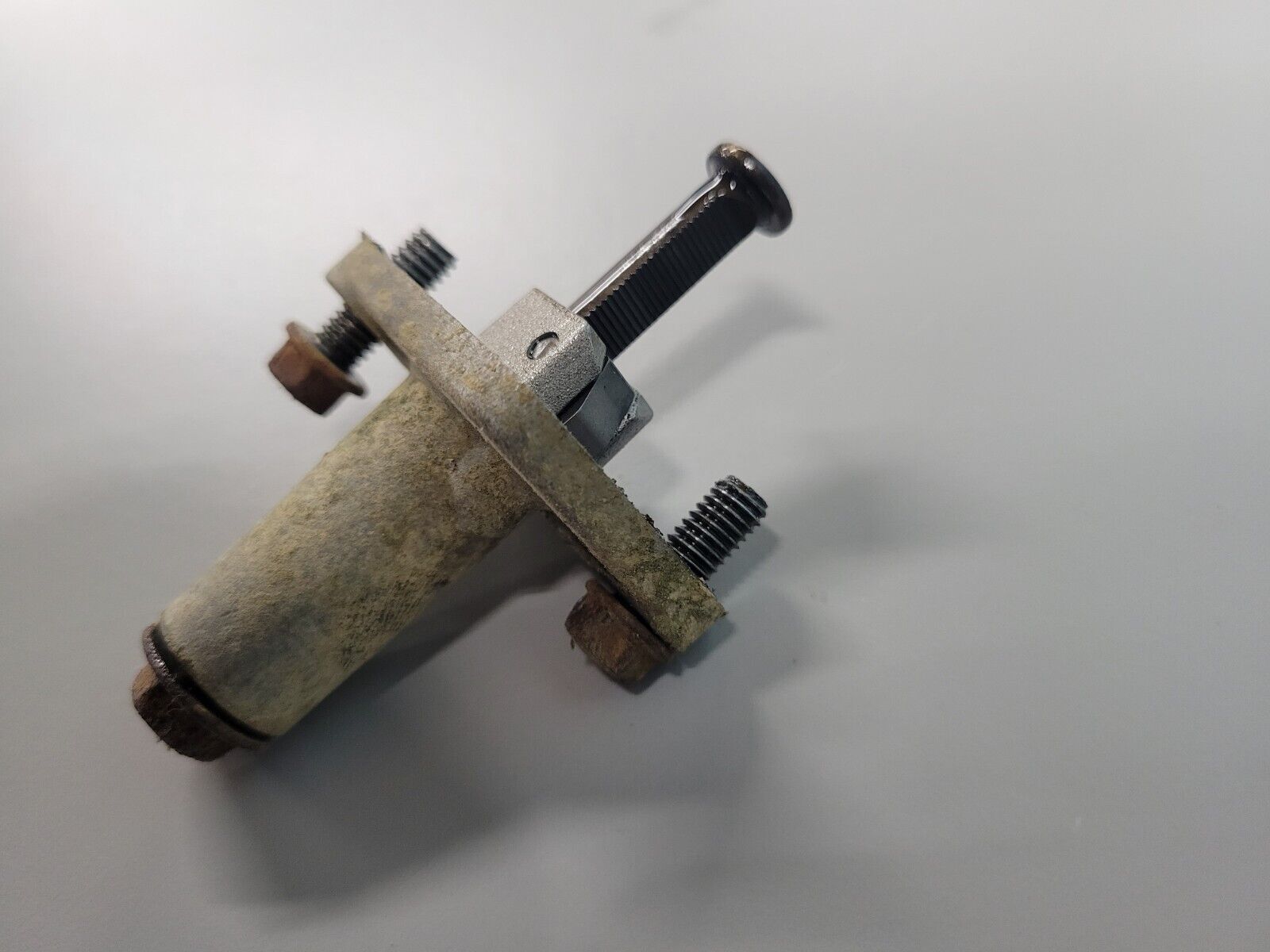

Thank you for the idea. I did take it off and it has a little arm that has indents in it that seems to be completely extended and can`t extend any further. I`ll try to get a pic tomorrow and post it in case I am not understanding how it works.

The tensioner looks just like this one, but cleaner...
Get a service manual. Usually I just find someone that has a pdf download for 10 bucks or so. Worth every penny every time. Some things on bikes are unique and there is no cross to automotive knowledge. It will show you how to replace the timing chain too.
