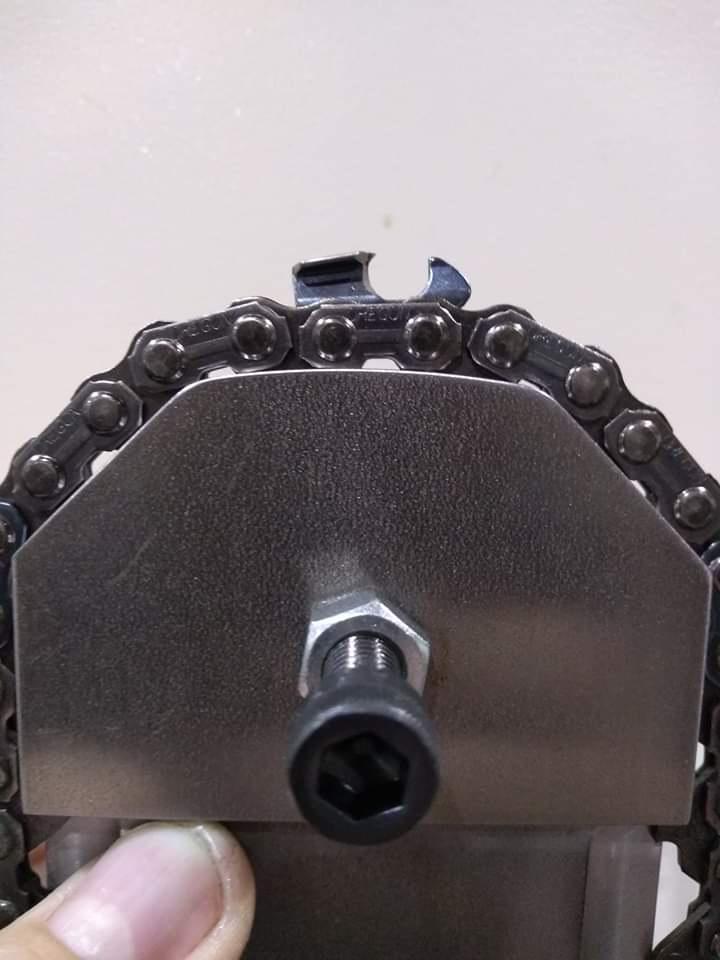

Does anyone know what chain vise he is using in this video?
Here is one I have made to sell.
