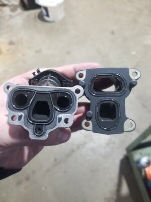

Just something I noticed with these strato saws, figured it could start a good discussion.
One of these makes about 10hp and the other is around 4.5hp
Knew the intake was small, but didn't realize it was that small.
881 right, 550xp left

Look to the strato's and their butterfly valves to make up the difference in volume. The carburetor doesn't need to be bigger, just needs to be able to meter the extra amount of fuel out so when it finally gets all mixed up it ends up at the proper amount. As with bigger strato's the cleaner, more efficient the whole process is.

Look at the transfer inlet AND the intake port. Then ask yourself how it makes 10hp using those small passages.
Hint....it ain't the fuel side of the system that makes the power.
Strato engines often have over 100% of the bore in total intake width.

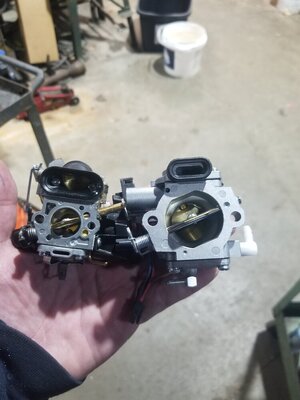

Yes, bigger carb, but split design, as well as the big one doesn't go anywhere near the RPM of the little one reducing its requirements in that respect. A bunch of math will explain it best, I believe.

Carb isn't divided. Intake is though.

The strato inlet area appears similar.
The outlet area is for sure smaller on the 550.
I just found it mighty interesting is all

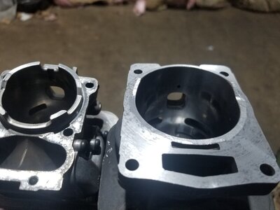

Like Randy said, it's the length. I can imagine it taking less than a blink in time to fill.
Yeh the 550 has a longer strato length. From the boot to the first entry to the cylinder wall.

Look at the transfer lowers.

550 has large lowers for sure. All the 5 series husky are rather large.
Yeah, I think the stuffed huskies hold a lot of their case volume in the transfers. They also push the flow out to the sides a lot more abruptly.
Does the case gasket divide the transfer feed in a 881 case like it does in a 462?
