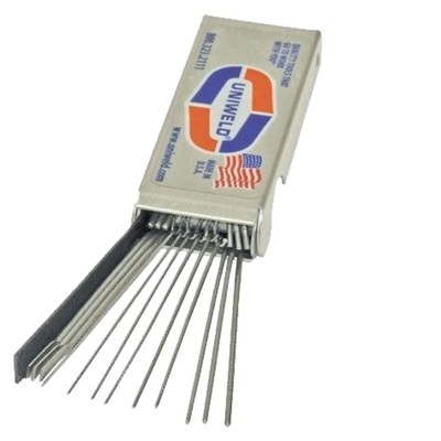

I've taken to ordering older main jets for my Honda carbs. Seem to run more smoothly. Main jet dimensions have not changed for decades, only the size of the holes. Yes I have used a tip cleaner to slightly enlarge not the main jet, but the orifices on the body of the main jet.
