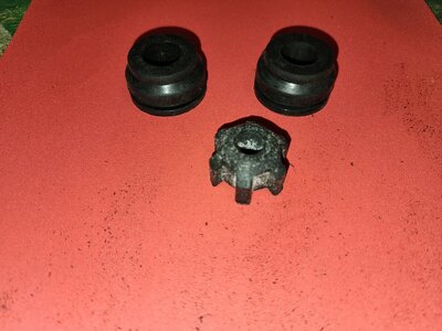

If any of you don't like AV that makes you feel like you're having a threesome with two fat chicks in a half ton truck this is the solution for a 362/400..it fits on a few others as well, you gotta trim the buffer that goes behind the coil..it's self explanatory.
Now when you turn the saw PTO side down it won't feel like you can use the bar for a diving board.
Sawzilla sells these. Not only are they stiffer but they last longer than those foam pieces of *s-wordt.
You're welcome.

The buffers are your best bet.
DucTruckin379
9:19 PM
24436
Aug 1, 2022
40
87
AL
Awesome, these were the ones I thought about trying! Unfortunately I never did. Glad to hear firsthand that they tighten the saw up! Now to order a set...
