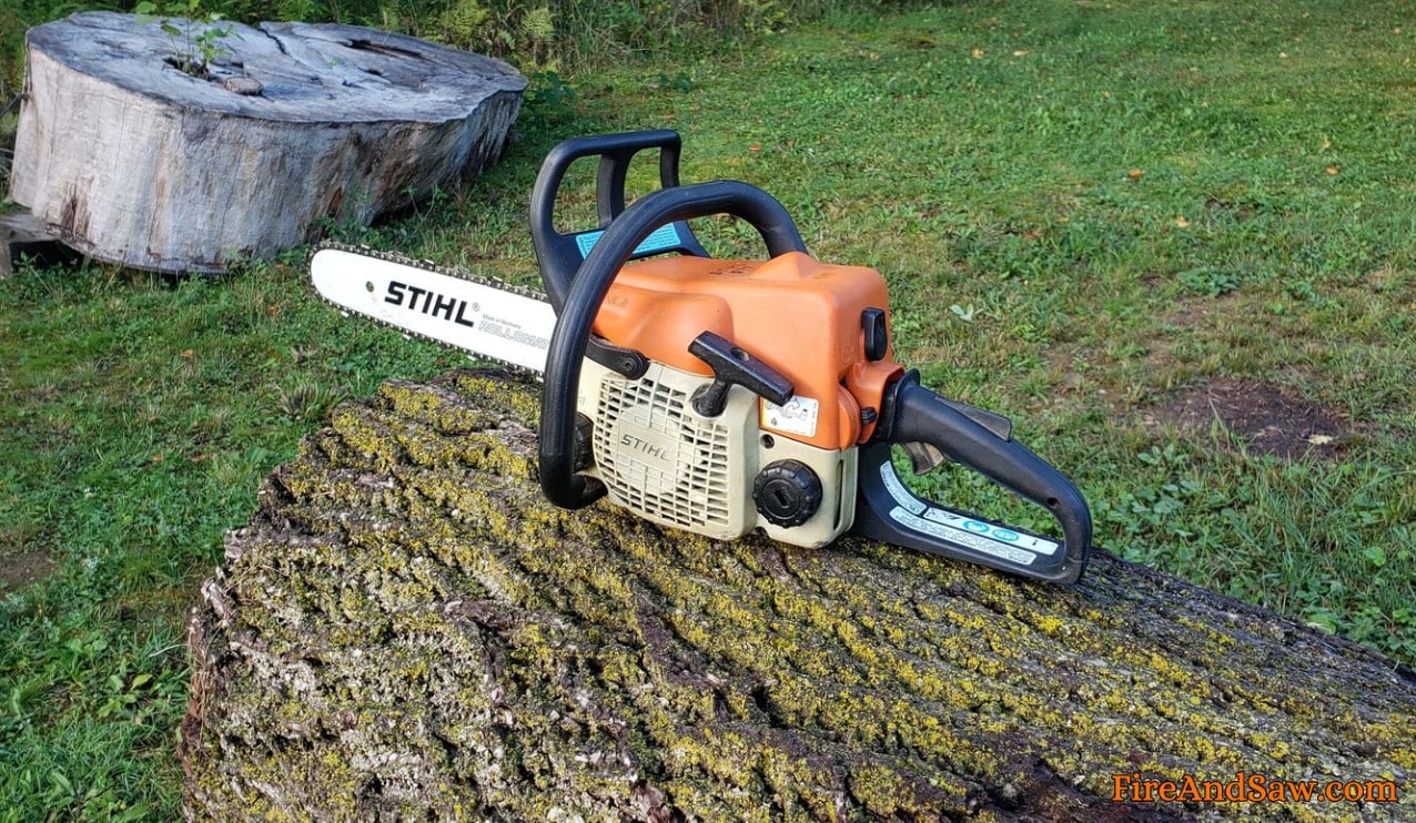

Has anyone ever come up with a match for Stihl White spray paint?

There is a rall code for an aprox colour, iirc it’s a little like some tractor white..
I think someone took a new cover into a paint place and got it scanned ;)
there are a few problems with spray cans. . where as powder coat is longer lasting
I,m not sure about the 2 part paint. But I guess @Glock37 is the person to ask ;)
Like the other guys said, the Ford light gray is very close match. OEM below:
0000 000 2102 oem stihl 12 OZ. Aerosol
They call it "gray" not sure if they have anything labeled white.
Can get from stihlership or online.

"In 2008, Andreas Stihl AG & Co KG ("Andreas Stihl"), a German manufacturer of chainsaws and other handheld power tools, filed an application to register a colour sign as an EU trade mark (EUTM) for 'chainsaws' in Class 7. The sign was a combination of colours per se (i.e. colours which are not spatially delimited) comprising 'orange (RAL 2010)' and 'grey (RAL 7035)'."
So we know that at this time in 2008, these were the colors trademarked by Stihl.
Don't know anything about this site, but information seems legit. YMMV
