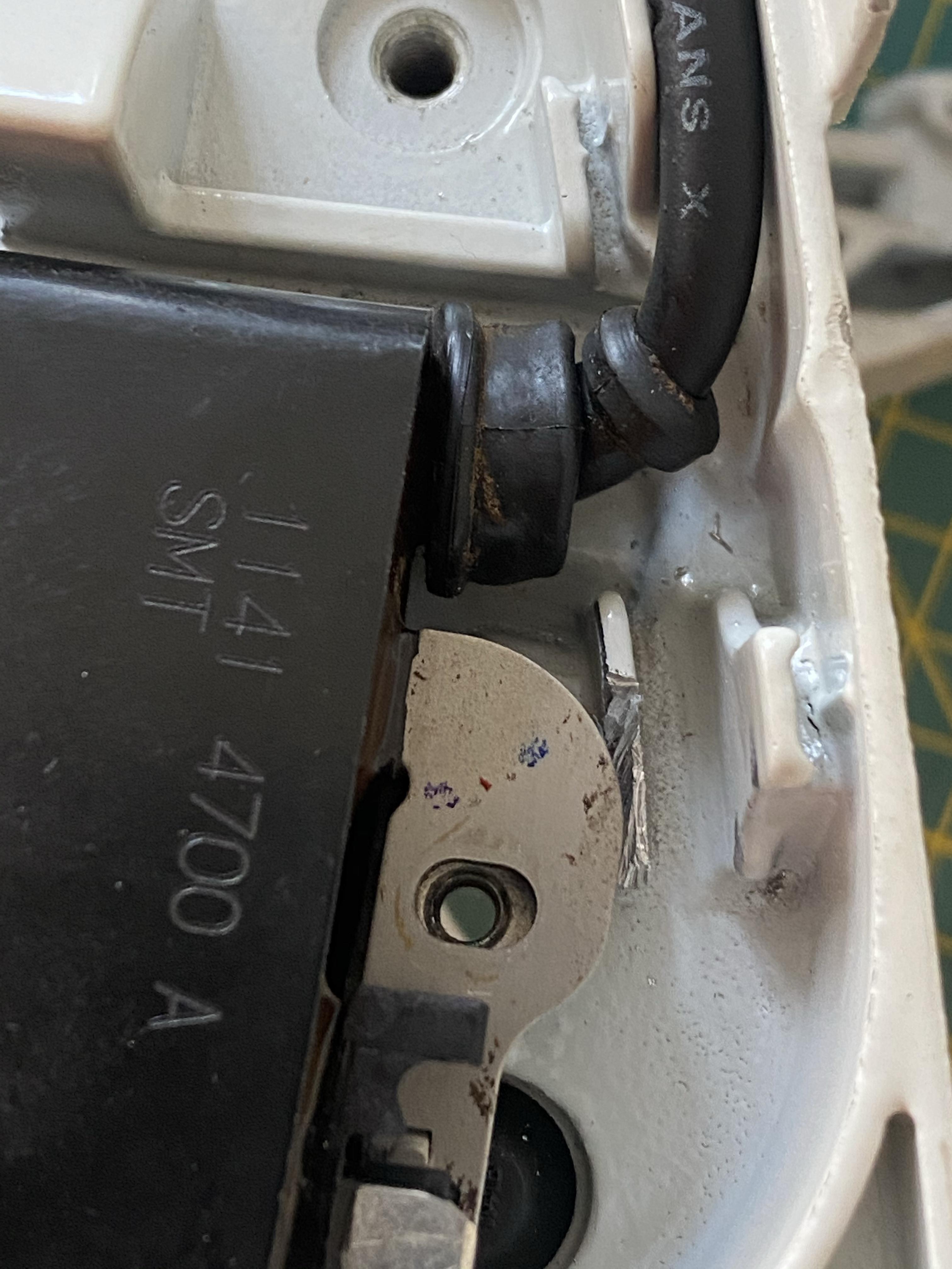

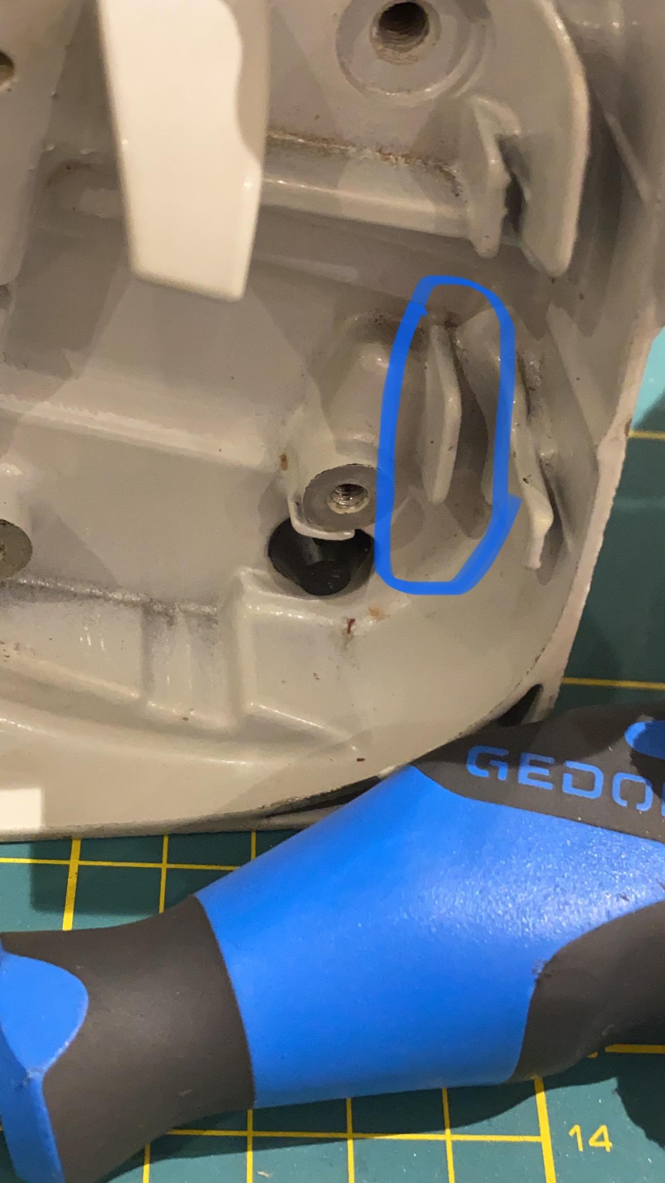

Not MS441, but the only difference on the MS261 carb and MT is the area around where the coil is mounted. I went from carb to MT. Here’s a couple of pics, first is carb case, second is carb case “modified” to accept MT control module, otherwise there is no adjustment to air gap.
