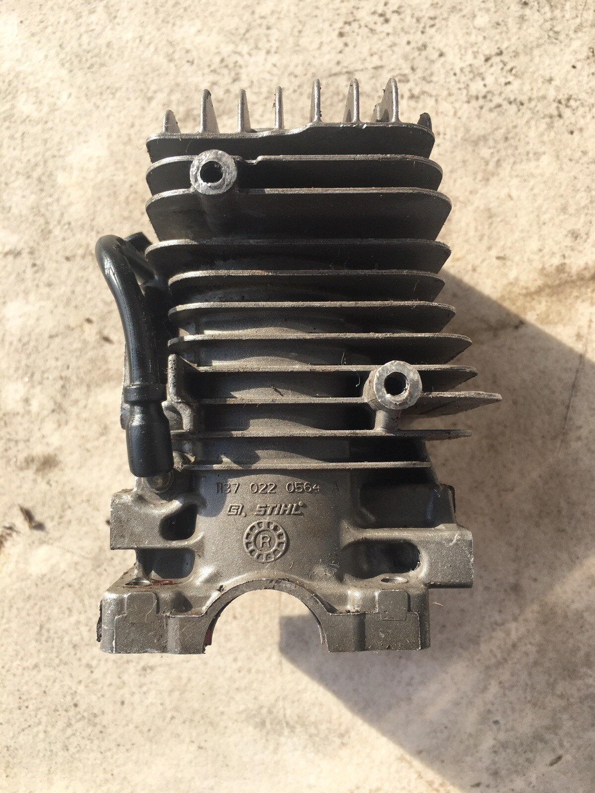

Stihl part # 1137 022 0564a is this an early or late cylinder for a ms192t?

I can`t tell you, because the number is wrong. Often there is not the right part no. on the part itself.

I got that number to come up on ebay. other than that I can't find it anywhere

Reason for the question is; I’m looking for a early 192t cylinder, without the exhaust relief port, like in the 192tc cylinder

Cylinder without pre exhaust groove is 1137 020 1203. If your saw is a previous version you also have to use the newer intake manifold which is normally used from machine 271210654.
