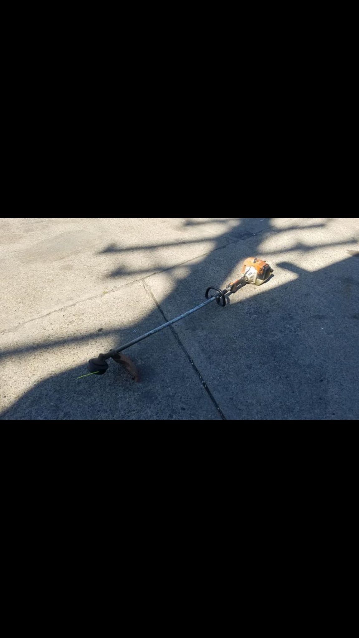

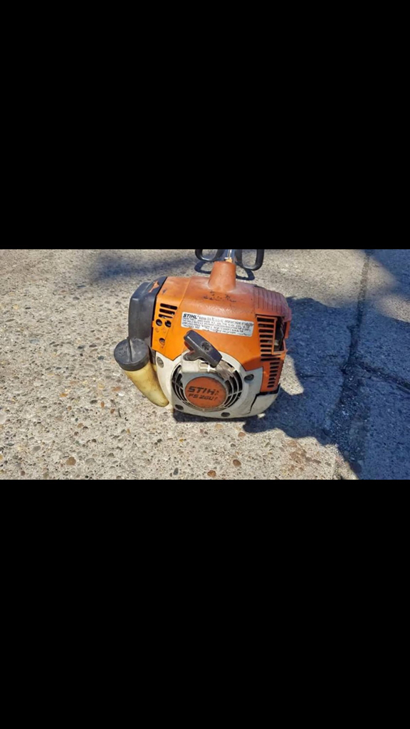

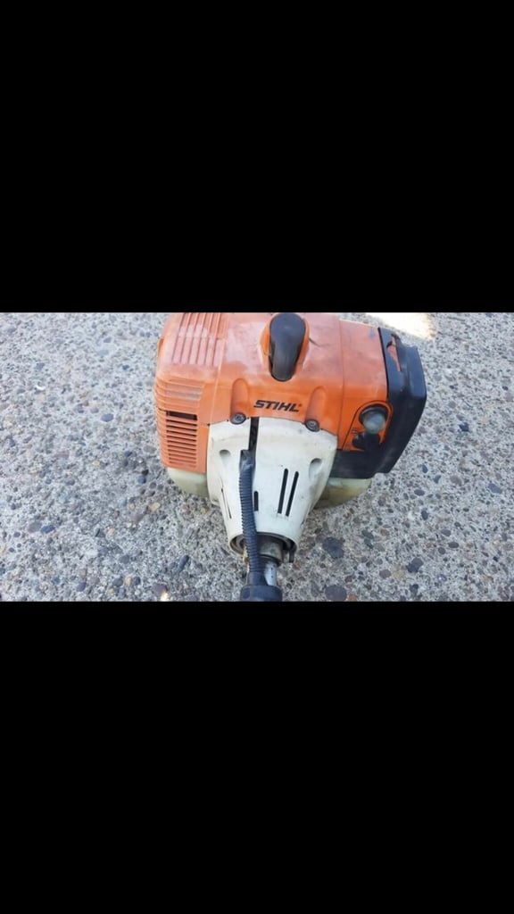

So I just picked up a well used 250R that I believe needs a carb. Runs very poorly hard to start. Is there anything else that I should do to it besides the carb and spark plug? Are all the carbs you can buy basically the same? (junk) I bought a tune up kit from Amazon to at least see if I can get it to run decent. Wish me luck
