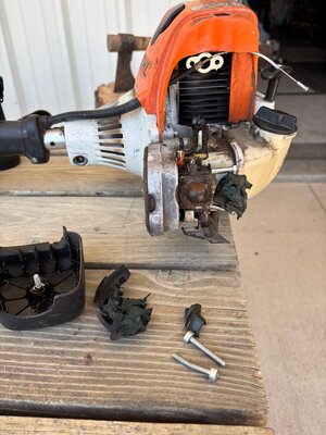

Good day all, whilst pulling a much bigger trailer than I was used to attempting to bring my gear into town to help a friend last weekend, I pulled this string trimmer along and broke the green plastic carburetor mount? off and bent a few bolts. Attached a picture. Do you all think my best bet would be to try to source these specific parts individually or maybe find another full unit to pull from? e-bay has some things individually but I am in small town country without a nearby Stihl dealer.

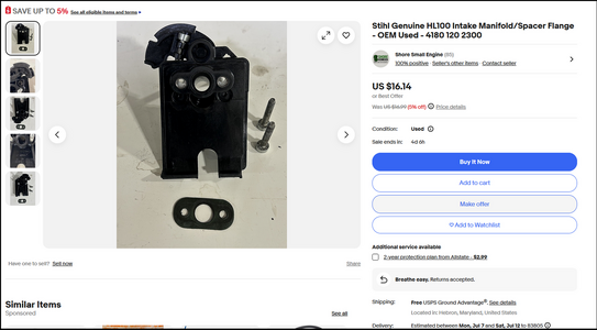

I am guessing it is the spacer flange you are needing (same part as in the HL100 hedge trimmer):
Found it on eBay: Stihl Genuine HL100 Intake Manifold/Spacer Flange - 41801202300 There are several different on-line stores that show to have the part for sale, but do not offer up a picture, so it is hard to verify before purchase. From what I have seen the stores are showing betwwen $15 - $25 plus shipping for the part. The unit below is $16 with free shipping. If you feel that you might need more parts later, then it might be wise to get a parts trimmer, but then you will need to find a place to store it and keep tripping over it until you might need a part again. Or be like me and get the itch to get it running again and then have two running trimmers... :D

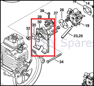

Thanks a ton for digging that up! That diagram is super helpful, I may need that #34 bolt also. Will report back if I experience anything worth sharing in the process.

No problem, here is the link where I got the IPL from (DIY Spare Parts FS 100 On-line IPL), it will provide you with the Stihl Part numbers. @ray benson , can you provide @onswangs with a .pdf version of the FS 110 IPL and service manual if it is available? Thanks!
