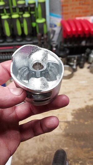

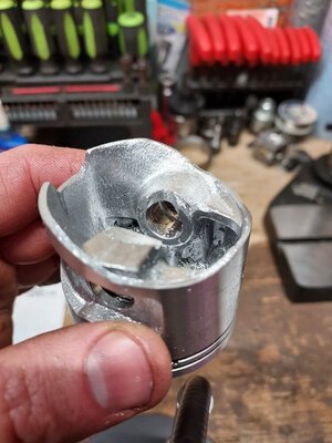

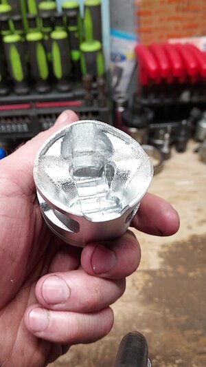

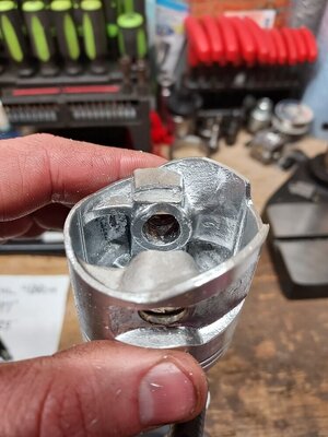

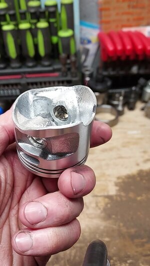

The piston I ordered from VA came in not finished... I had to clearance the bottom as well as the inside... took some work, but we got it done.

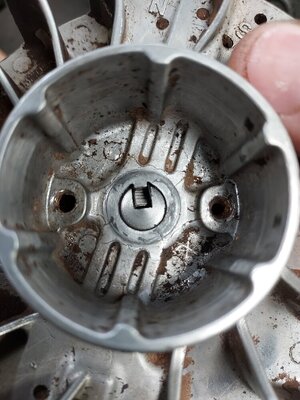

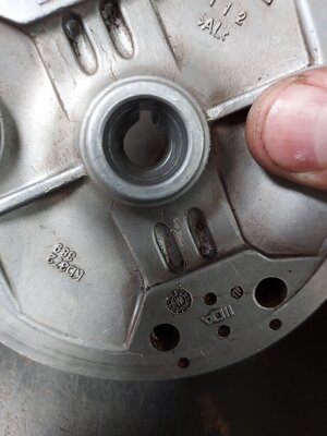

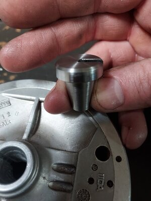

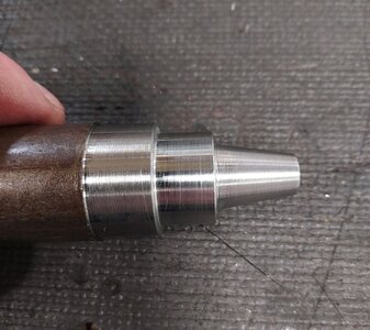

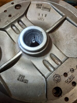

Once the piston was done, we moved onto the flywheel. The flywheel key was sheered.... My "I'll just make and a tool and fix it" kicked-in... why? because I didn't want to spend money on a new flywheel for an old/used saw. That and I couldnt justify spending $90 on a used flywheel... so, I made a tool and broached the flywheel.

I completely agree. My piston selection was solely based on cost... OEM vs AM... I've had good luck/success with a few AM products... I figured I'd spend half of the cost and purchase a pop-up... well, I saved money but lost time... lol. And I'm certain the AM piston is a pig (heavy) compared to the OEM piston.

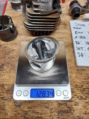

You can see on the piston, the bottom casting was never completed/removed... and look at that total weight!!!! Those are my numbers, I'll probably go back into it, and slightly raise my uppers and play with direction. Intake # may be a bit heavy... but, that's why I am here... to learn and share my trials and errors.

I’d buzz the popup off. It’s deflecting the charge up, causing a couple things.
1) blowing the charge uphill raises rpm’s but at the cost of torque. Some saws like that, but imo it’s backwards on a 1st gen 462.
2) it could be shooting the charge uphill enough to mix with the spent charge and be lost out the exhaust
I never once thought about that... damn, now I'm going to be standing in front of my Machine thinking about that until I get home. Lol
I do have another piston, I'll turn the pop-up off of 1 piston and I'll do some test cuts this weekend and compare the 2 to see how the saw reacts. Pop-up vs Flat top.
Thanks for giving me some of your insight... my brain will be feasting on this for the next 5hrs.

I ain't no porter but I have a few saws by huskihl, and they pull...he and the other porters around here generally don't recommend popups.
One of the first saws I messed with modifying was a Stihl 028 super....even after machine work, port work, muffler mod, etc. the saw was meh. Those saws have a huge pop-up on the piston....maybe some day I will get to do another one with a flat-top piston.

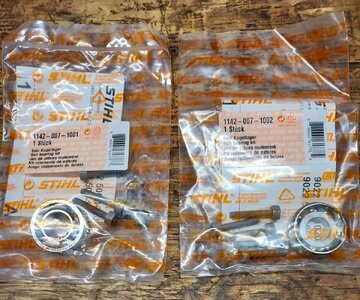

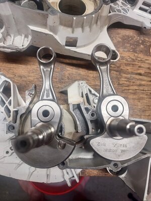

Just a side note... I don't have 462 bearings in this saw... one is a koyo and the other Is the west ??? BUT... seeing how I am expecting this saw to fail catastrophically, I have a complete gasket set, bearings and seals ready to go... my other thought was, if I don't like it, I'll machine the case "slightly"... turn the counter weights on a 460 crank and make a stroker... 462c 77cc saw would be nice... Light with the power of a 461-ish...
I agree with that about pop-ups. It's no different in the racecar world... dome pistons give power and add torque but you also sacrifice efficiency... and in my way of thinking, the smaller the motor, especially a 2 stroke, you want that motor to be as efficient as possible... with that said, depending on the build, I'll do a flat top, I used to always chamfer the piston and squishband, but... I'd match the exhaust roof and floor so that the flow is streamlined... on some cylinders, that's not feasible or even possible... other saws I'll do a pop-up, swap pistons etc... it just depends on what i want to tinker with. But, all-in-all... flat tops seem to yield great results.
