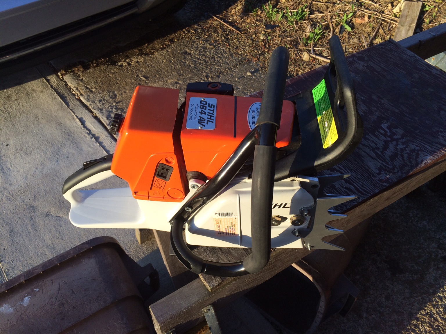

Wanting to buy 2 brake flags that go with the 3/4 wrap handles. If someone knows where I can guy one I appreciate it.

Don't know any numbers. Just know there are two different ones and one doesn't work with the 3/4 wrap handle.

Looking around I have found a 9100 and a 9103. Now to figure out which on fits if it really does lol.

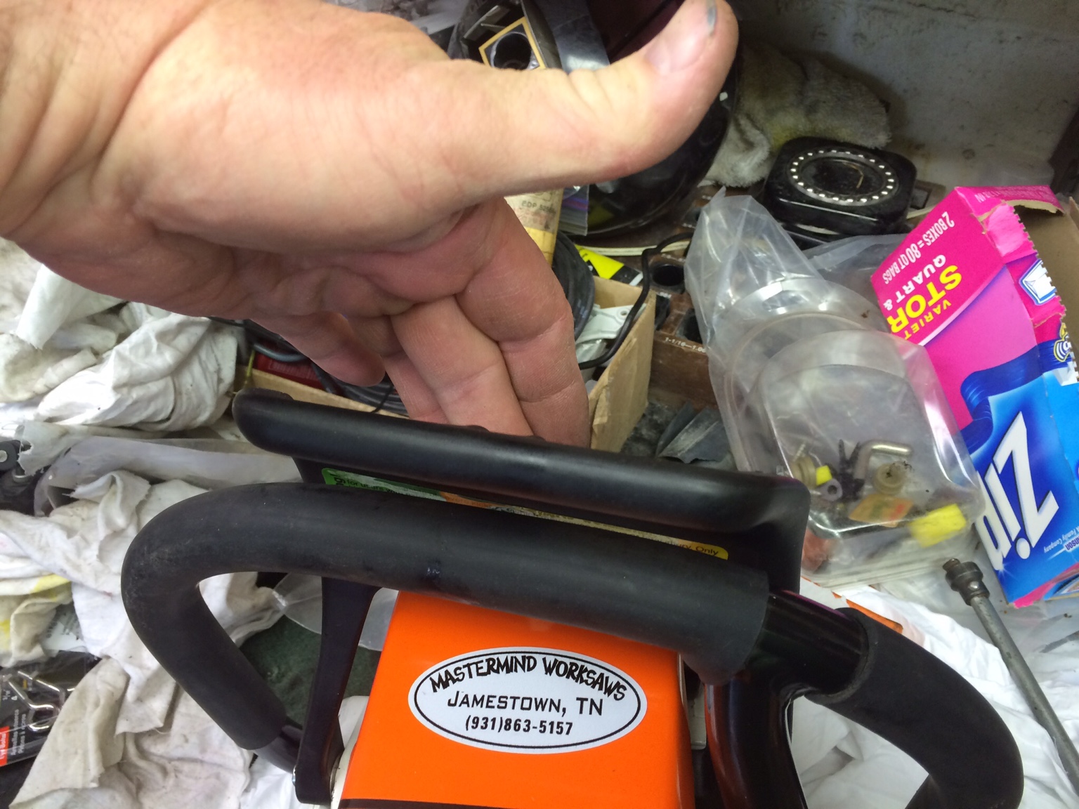

I have one on it now that I had to shim like that. Though it was just the wrong one. I will check the numbers on it. Who knows may have the right one and didn't know it lol.

I have a 9100 here that's too narrow to go on a 660.

I've got a 9100 on my 064 with a half wrap. It fits perfect without any shims.

I have a 9105 but wont use it, when I run a full wrap on an 064 I use the 066 brake handle with an extra rubber buffer on the bolt

The normal flag for a 1/2 wrap will work with a newer style 3/4 wrap handle

The 9105 will lave a gap the other will be on the same angle as the handle

The new style 660 wrap like yours they made so you can use the same 9101 or 9103 1/2 wrap brake handle.
