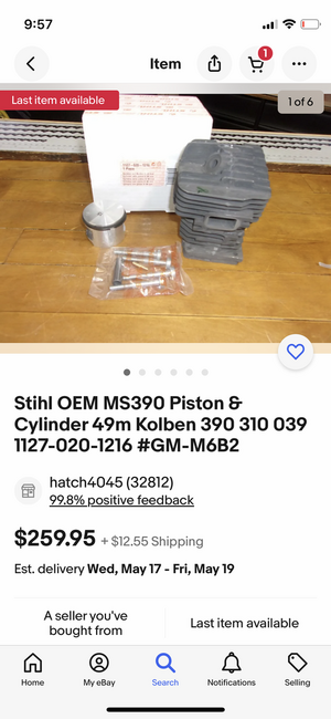

I'm repairing this saw for a friend. He bought a Chinese cylinder and a Meteor piston. I put it together and it has low compression. I want to use an OEM jug the second time I build it.
The 039/390 can be decent runners, but you will need an OEM cylinder…might try a Dukes if you can’t find OEM.
