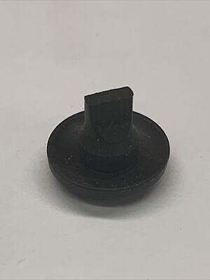

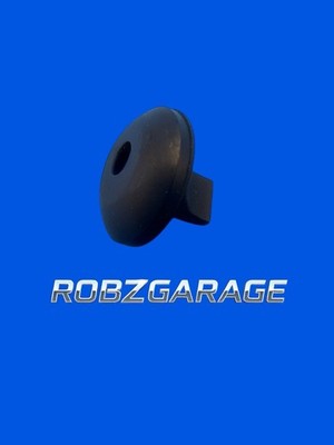

Try and measure that hole you have. This black one is about 1/4" where it inserts. The other one, red, is about 1/8". I have those as well
