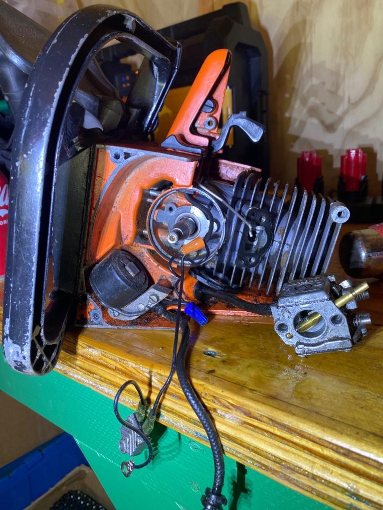

This is the first saw other than a 660/460 that I’ve cracked into in quite some time. Cant get the old girl to run.
Got fuel, spark, compression.
Cant even get a pop out of it.
Cracked the side cover and found a mess of wires spliced together with residential wire nuts.
Got to searching the web and came up with some questions…. IS THIS THING SUPPOSED TO HAVE POINTS??
Again I know nothing about an 015, ide like to either redo the wiring or buy a NOS coil and wire set.
