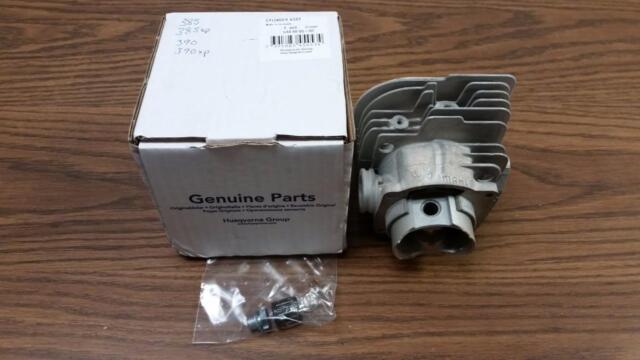

Take a real real good look at a 385xp or 390xp cylinder and piston. Compare it to a 372xp. See what they did there from the factory? That was the inspiration behind this type of mod. Now there are many ways to skin a cat. The only way to find out what works for you is to test. If I were you I’d practice on a cheap cylinder or one that’s already junk first before grinding on an oem 372 cylinder if it’s your first time.

That's what I thought too, but at BDC it is the piston that is lowest. I'd have to take the piston skirt up..
Look at that part of the 372 skirt and look at the same area on a 385/390xp skirt.

I copied what they did on the 385/390xp cylinder and piston on a 365 special as well as gave it a woods port/popup piston. Turned out pretty good for basically an experiment out of curiosity. The saw seemed to gain a lot more torque and vibes were less from the lighter piston. Am I saying this is the right way to go? Nope. Many ways to skin a cat. 94F77904-D174-42C9-82DA-68F2CF5D15C2.pngC76F56BB-0F9B-4D97-A12D-4D8A4B4A8EBF.png That’s a 372 skirt I lowered but the 365 is the same.
