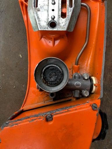

Anyone know where I can find a new rubber biscuit goes between the pump and crankshaft end?
IPL I have shows a spring there.
[emoji3166]

It’s just a wire (stiff one) that’s curled up to engage the clutch. I’ve heard of guys making a part that will work. Here’s some pics of the one on mine. Also, if you have an extra white plastic cover that goes around the carb and all I could sure use one. EEE23E4B-FB21-484D-9B2D-8432B3ACABC7.jpeg1C8930CE-4B41-4421-A0AF-D5E93661DC23.jpeg21E7773C-6574-4E0E-8F2D-2A553EDAAA45.jpegIt looks to me like the screw in the middle is used to swell up the shaft the spring slides over to retain it once it’s been installed.

I’ll give the rubber biscuit a go first. [emoji1696]
If it don’t work I’ll bend up some coat hanger wire.[emoji6]
