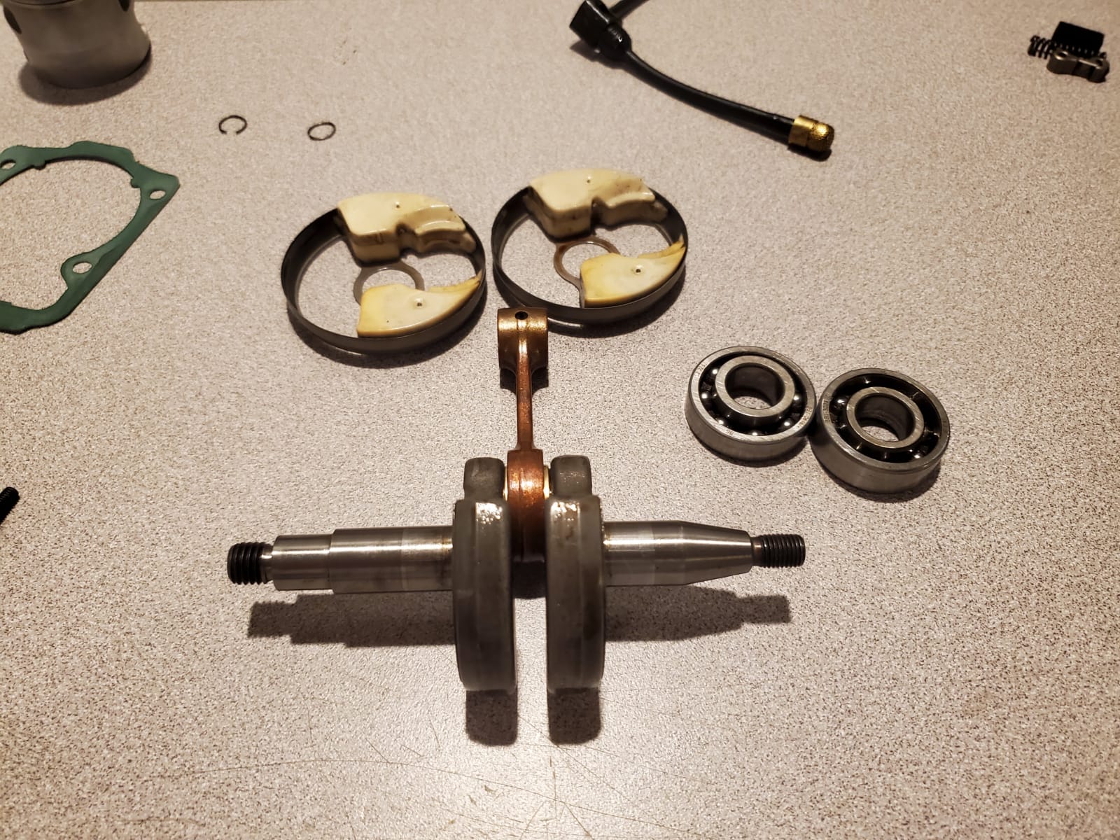

Hi guys,
I was wondering if someone could explain to me what "crank stuffers" are?
In a thread posted here,someone said they needed to crack open a line trimmer engine to see if it had crank stuffers.I've never heard this before.I assume it's slang?

These are the crank stuffers on a 562xp. I believe they are used to reduce crankcase volume. Someone smarter than I can chime in and explain. Pics are from @JoeDirt.

Crank stuffers are used in 2 stroke engines to fill voids in the crank to reduce volume and increase primary compression. In the old days we mixed ground cork with epoxy glue to fill crankpin holes in motorcycle racing engines. There are also reed stuffers or box stuffers for reed valve engines.

Ok,gents,thanks for the info.Next question,if I was to look at an IPL for that chainsaw,what would those parts be called?Is crank stuffer the technical term for them?

505 13 36-01 CUP
