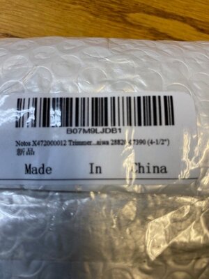

Thanks for the reply. This is the package that I received. I am leery of reordering them because I cannot find any advertised with the dimensions posted. Any ideas of where I can get the correct one?

If I was in your situation, I would order a 400 head, keep the X472000070 cap for a replacement, and return the incorrectly labeled cap. The 400 heads hold close to twice the string of the 375 even though they're about the same physical size.
I just ordered the cover from your ebay post. Hate to buy the complete head when I only need the cover. Hopefully it will fit.
Thanks for the info.
