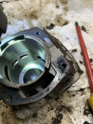

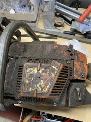

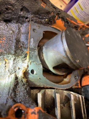

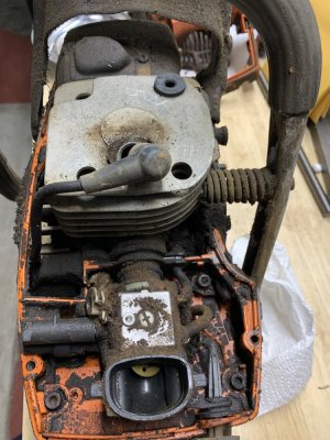

Well, I got the 365 tore down as far as I could go. I was hoping the cylinder and piston was seized as I knew it was locked up, but I pulled the cylinder off and the bottom end is locked up. I guess I will order a case splitter tomorrow and work on it some more next week. I will clean it up and degrease all the plastic this weekend. She is a dirty girl, I don’t think this saw was ever wiped down. Depending on the failure in the bottom end, I suppose I might be putting a crank and bearings in the saw. Have you had a bearing fail and seize up the crank? The cylinder does not look scarred up.
More to follow.

Looks like some corrosion in there could have corroded the crank to the case. If you heat around the bearing pockets and hit the crank with a rubber hammer you should be able to split the cases without a case splitter then you will just have to use a puller to remove the crank bearings from the crank if the crank is even any good

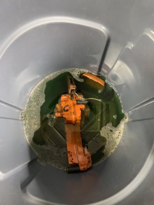

In a soak of simple green and dawn.

Soaked for several hours, not much good but can see orange now. Didn’t get to split the case. Hoping it’s a shaft bearing and not the rod.

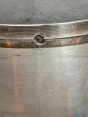

Look at this ring, just now noticed this.
