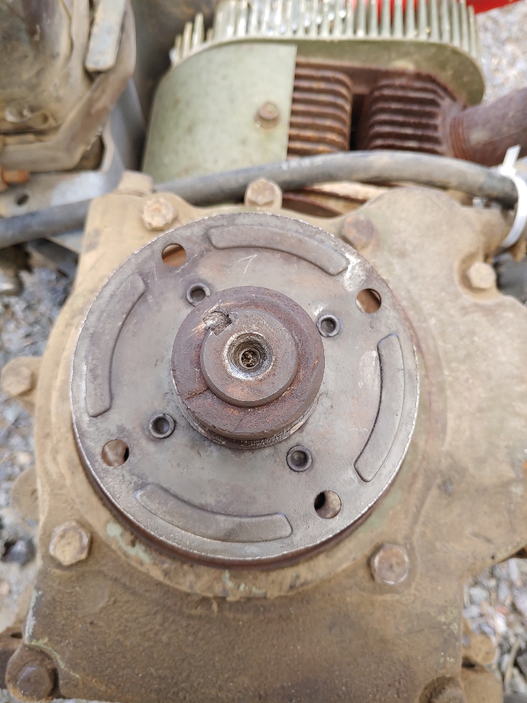

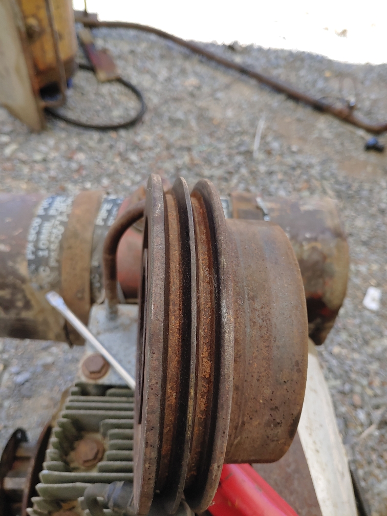

I have a single cylinder Wisconsin with a 6" centrifugal clutch on the 1" shaft.
The outer drum was attached with a C clip and came off fairly easily.

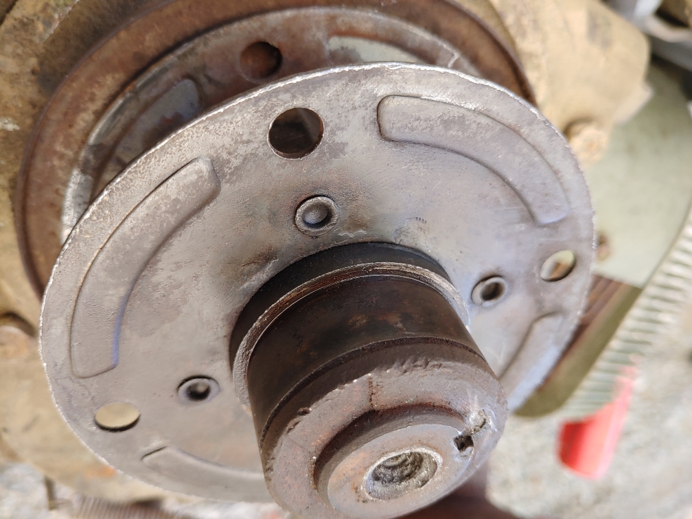

The actual clutch is a different matter. I do not see any set screw holding it on the shaft. There us a keyway on the shaft.

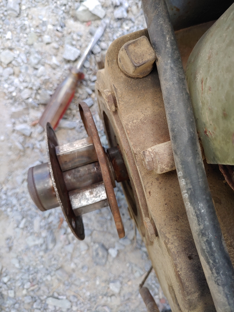

Rear plate is too thin for a three jaw puller and I can't get a bearing puller behind the clutch.
I don't know if the C clip that holds the outer drive on the clutch is strong enough to pull the clutch off the shaft.
Any thoughts on how to remove this?

I guess it could be threaded but doubt it, probably a "slip" fit that has gotten plenty tight over the years. I would find something to slide behind the clutch and hang the motor a 1/4" high then get out the oxy acetylene, heater up the outer bushing and tap the crank shaft down out of it.

Heat it very hot then freeze it (or at least cold water) that should partially break the rust connection a bit. Then heat again. Press , A or H type would be best( hate pounding on end of a shaft ) if you can get some steel bars in between . There are bearing removal units that are 2 tapered sliding plates ( wedges) that have bolts through the sides as you tighten them, they side together in theory causing the parts to separate - much better than any jaw type puller
