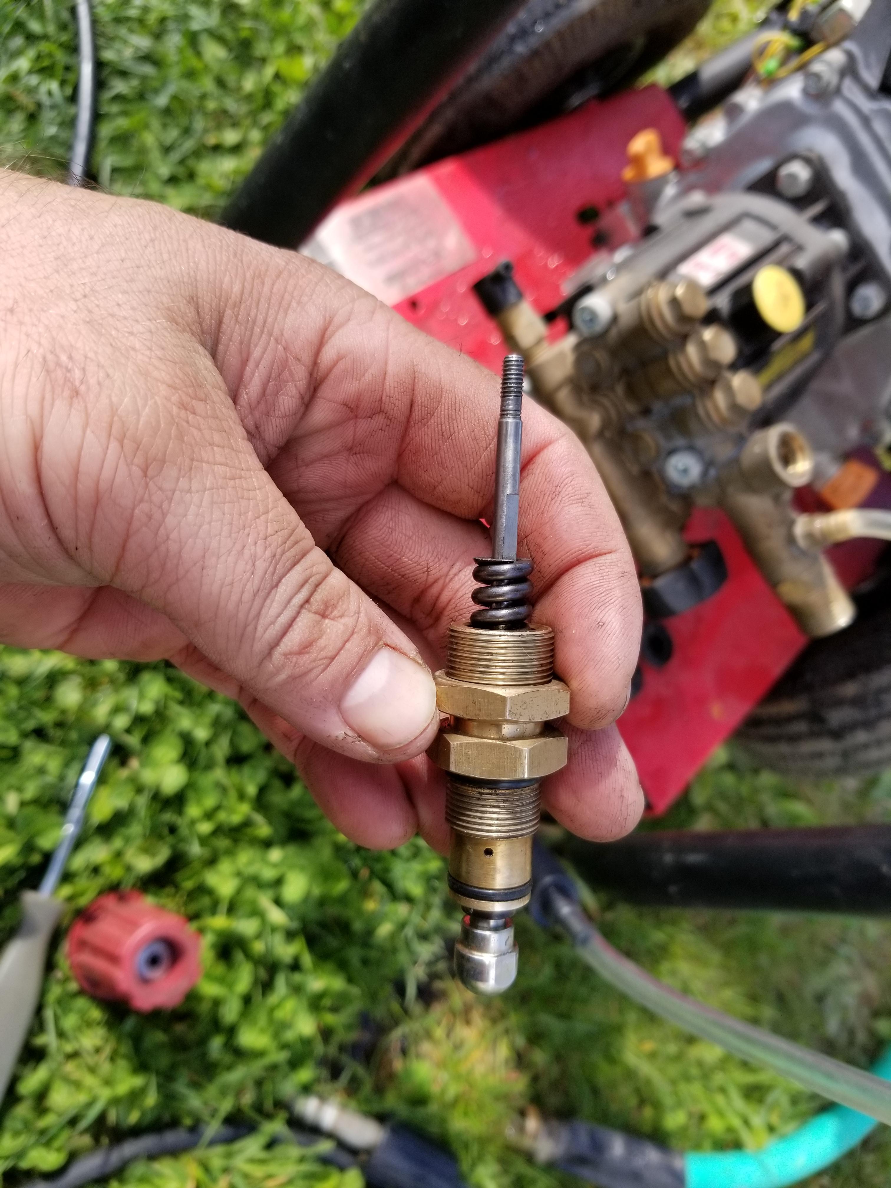

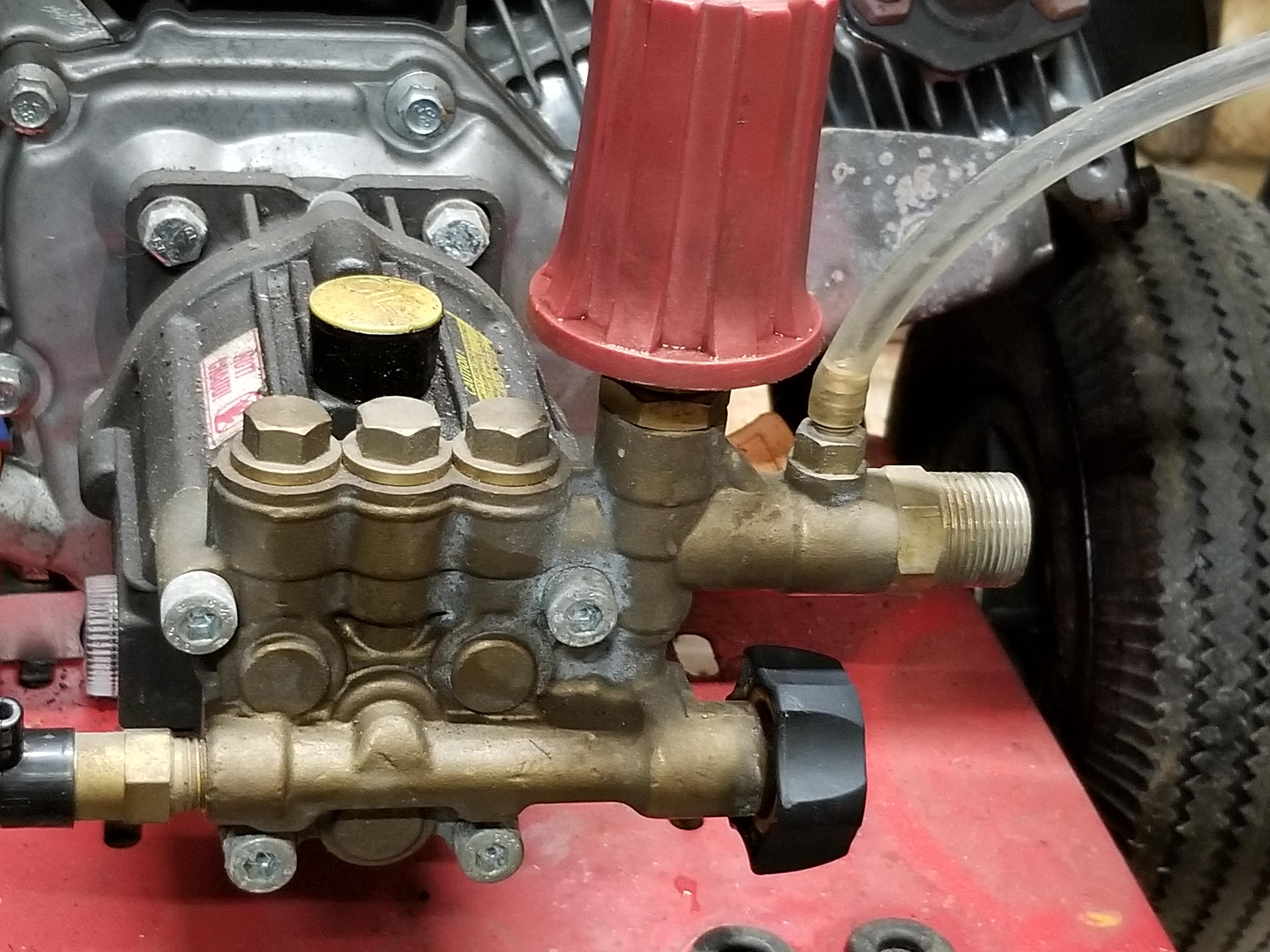

My gas power washer is making pressure but when i let off the washer wond handle it stays high pressure. I researched and sounds like a unloader valve. I pulled it out and cleaned it( have not retested yet) but it looked fine.( Unloader valve is under the red turn knob i think?)
My question is whats under the three other caps and could that be part of the problem?

It does sound like the unloader sticking.
After sitting the can stick. Sometimes if you pull the trigger a few times quickly it will jar it loose and then function properly.. Try backing off the valve a bit too.
The other caps are valves, if it is making full pressure those are working.
I forgot to mention i had it out a couple times about three weeks ago. It worked fine. Then i re winterized it. Was supposed to dip below freezing.
I did pull trigger a bunch of times and it still wouldnt free up. What is it that normally sticks? I had it all apart and seemed fine. Spring has a ton of tention.

Brass is stationary. That unloaded looks clean to be sticking. Check and make sure you don’t have crap behind nozzle tips and stuck in trigger assembly

The stainless plunger and spring more, brass doesn’t. Pull the plunger and see what inside of brass fitting looks like.

It moves freely. Not sure if the plunger comes out of the brass?
All tips are clean. I have tones of pressure. It just wont kick the pressure to bypass when i let off the trigger.
I did get it to kick out once when i was messing with trigger at WOT which i dont normally run it that hard.

Is ther anything else it could be? I just cant see it being that unloader valve for how clean and free it is.

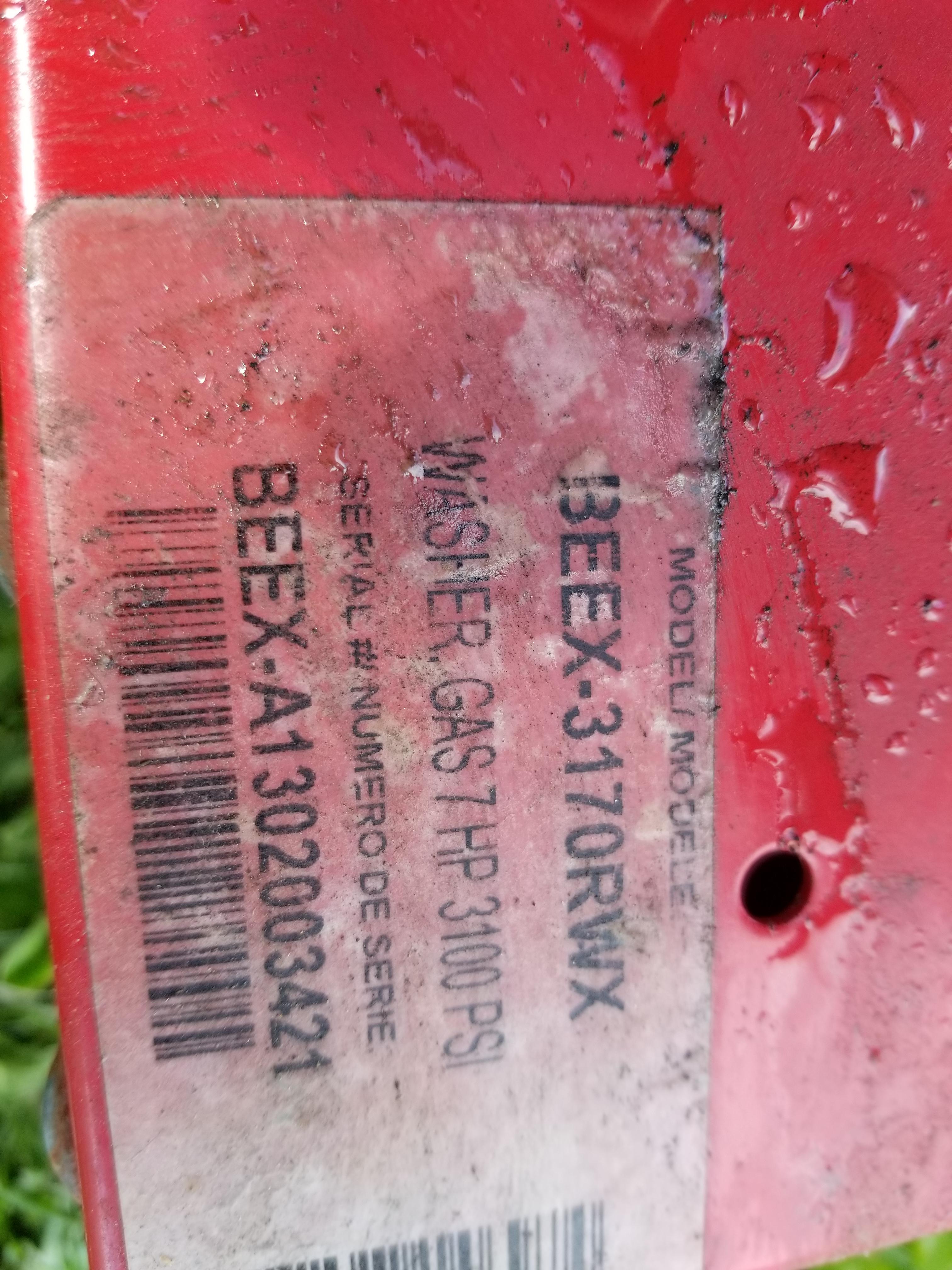

Can you get me the model info on pump so I can see the breakdown. If the unloaded is not much I would purchase one that style is None testable. Also check unloaded plunger seat on brass manifold
merc_man
merc_man
5:16 AM
933
Feb 24, 2016
4,952
21,578
southern ontario
I didnt see a number on the pump but got this if it helps. Its a BE brand.

So i stopped at the OPE dealer today to see about the unloader valve and soon as he seen the pic of it he said thats not the isue. He said pull the three caps off and clean the check valves and try it. So got home and pulled.them apart. Blew it all out and reasembled and it seems to be working fine.
Its always nice to have a good dealer that dont mind giving advice or i would have waisted 100 bucks on an unloader valve.
