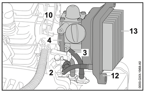

Merkava_4 Well-Known OPE Member Local time 6:29 AM User ID 6626 Joined Jul 7, 2018 Messages 165 Reaction score 136 Location Clovis, California Feb 27, 2026 #1 What are your favorite pliers for manipulating STIHL 3.1mm x 5.7mm fuel hose into place? Serrated or Smooth Jaws?

S singinwoodwackr Pinnacle OPE Member Yearly GoldMember Local time 7:29 AM User ID 34279 Joined Sep 14, 2025 Messages 1,112 Reaction score 3,272 Location moon Feb 27, 2026 #2 Merkava_4 said: What are your favorite pliers for manipulating STIHL 3.1mm x 5.7mm fuel hose into place? Serrated or Smooth Jaws? View attachment 484031 Click to expand... Old, serrated needle nose pliers or hemostat

Merkava_4 Well-Known OPE Member Local time 6:29 AM User ID 6626 Joined Jul 7, 2018 Messages 165 Reaction score 136 Location Clovis, California Feb 27, 2026 #3 singinwoodwackr said: Old, serrated needle nose pliers or hemostat Click to expand... Aren't you afraid of damaging the hose with the serrations? I see the imprints in the rubber from the serrations and cringe. The other day I had no choice though. There was no way to get those hoses on with just my fingers.

S singinwoodwackr Pinnacle OPE Member Yearly GoldMember Local time 7:29 AM User ID 34279 Joined Sep 14, 2025 Messages 1,112 Reaction score 3,272 Location moon Feb 27, 2026 #4 Merkava_4 said: Aren't you afraid of damaging the hose with the serrations? I see the imprints in the rubber from the serrations and cringe. The other day I had no choice though. There was no way to get those hoses on with just my fingers. Click to expand... Finesse is your friend. Don’t squeeze so hard I’m also using nearly worn out pliers so the serrations are about gone.

jacob j. Only the weird Staff member Yearly GoldMember Local time 6:29 AM User ID 232 Joined Dec 24, 2015 Messages 9,790 Reaction score 67,275 Location Coastal Oregon Feb 27, 2026 #5 You can grind an arc into each jaw of old needle-nose pliers to make them less prone to scarring up the hose. Stihl has a special tool like that for working the oiler hose kits on the 034/036, 064, and 084 saws.

S singinwoodwackr Pinnacle OPE Member Yearly GoldMember Local time 7:29 AM User ID 34279 Joined Sep 14, 2025 Messages 1,112 Reaction score 3,272 Location moon Feb 28, 2026 #6 jacob j. said: You can grind an arc into each jaw of old needle-nose pliers to make them less prone to scarring up the hose. Stihl has a special tool like that for working the oiler hose kits on the 034/036, 064, and 084 saws. Click to expand... Garage sale pliers, $2. Modified…

E EFSM Pinnacle OPE Member Local time 8:29 AM User ID 29079 Joined Apr 30, 2024 Messages 1,535 Reaction score 3,758 Location Extreme southern IL Feb 28, 2026 #7 Twist the line to break it loose from the fitting before pulling.
