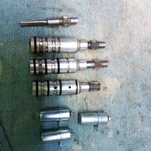

I got these in a bag of parts and have no idea what they fit or what they are ?
Any clues ....
Thanks
Ernie

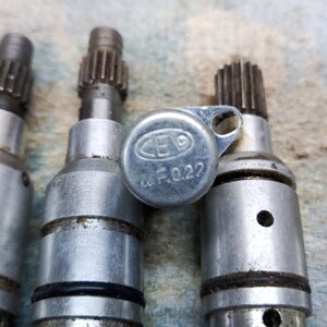

The condensers look like Jonsereds 111/11S condensers but I think they were also used in the XG, XH, 50, 51, 601, and a bunch of other Jonsered saws.
The bottom oil pump looks like Jonsereds 51/52. The middle oil pump looks like Jonsereds 50 and possibly 49SP.
The top oil pump looks like Jonsereds 601. The pump piston looks like an extra for the 49SP pump.
