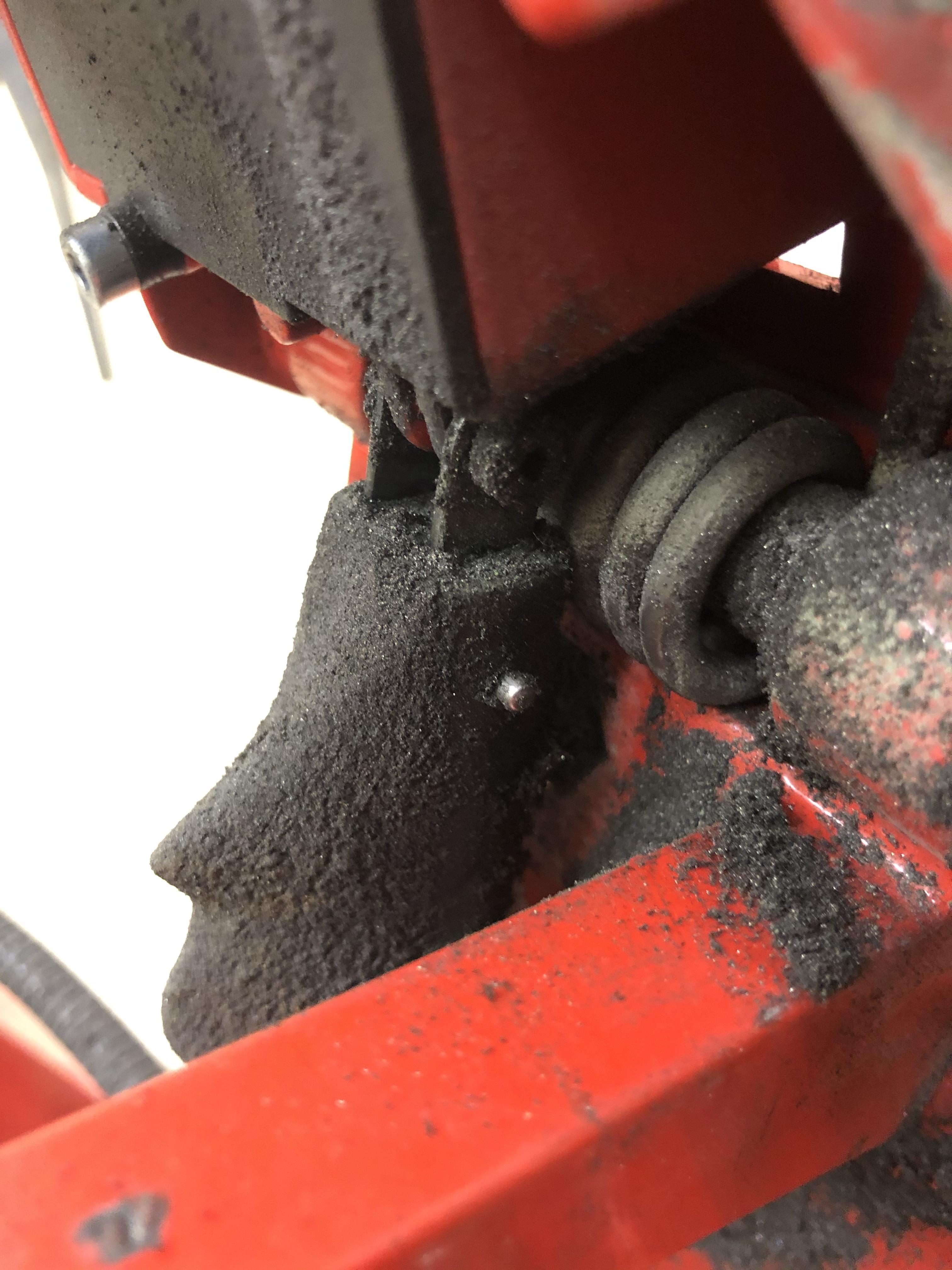

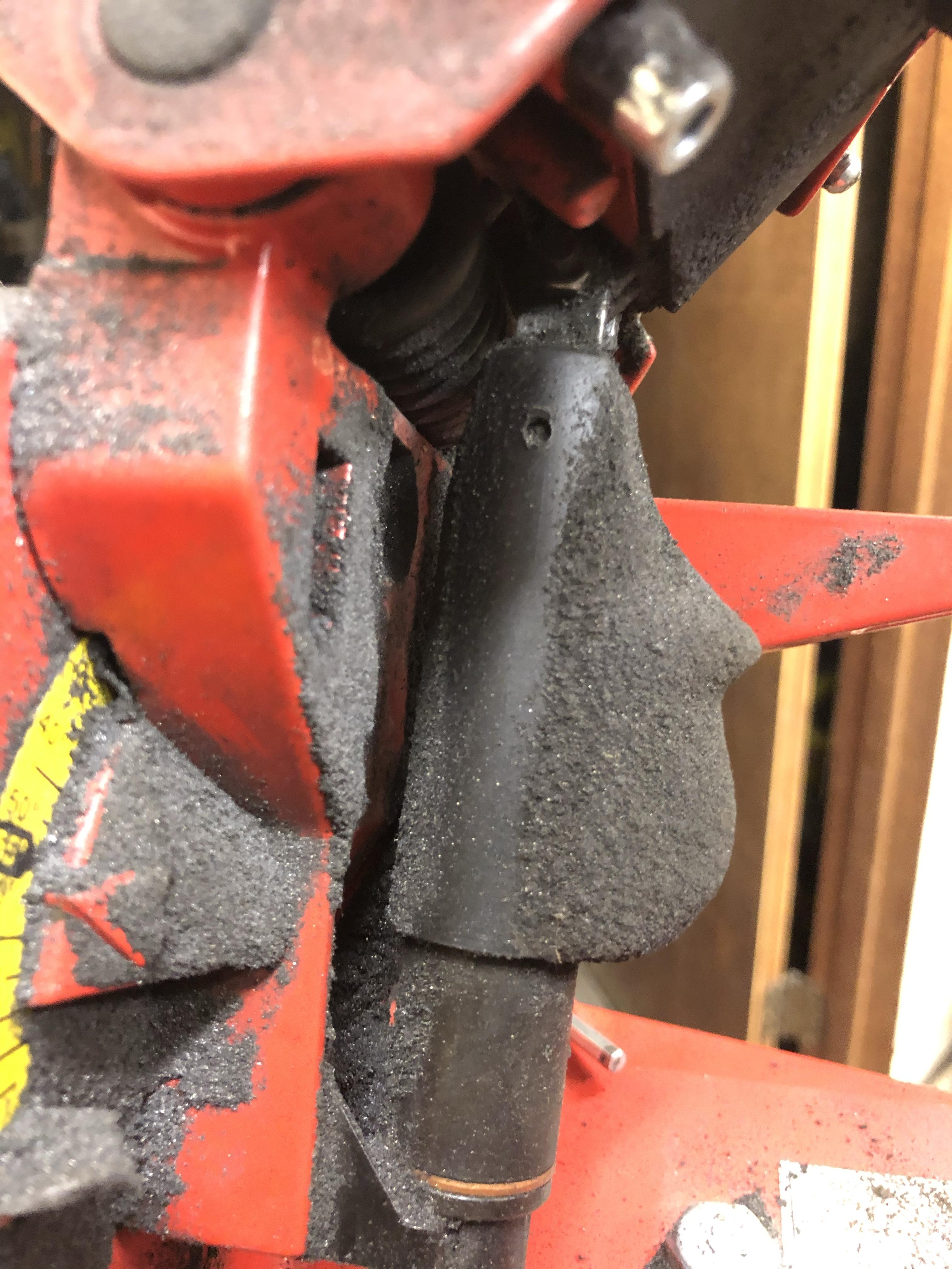

Where I’ve had issues are the pin that goes through the mount to the head that’s been replaced with a bolt as well as the pin that goes through the shield to the cylinder. That pin that goes through the shield requires some messing around to get back into its bore it required a set of needle nose vise grips moving the head as well a small straight pick to use as a line up tool.

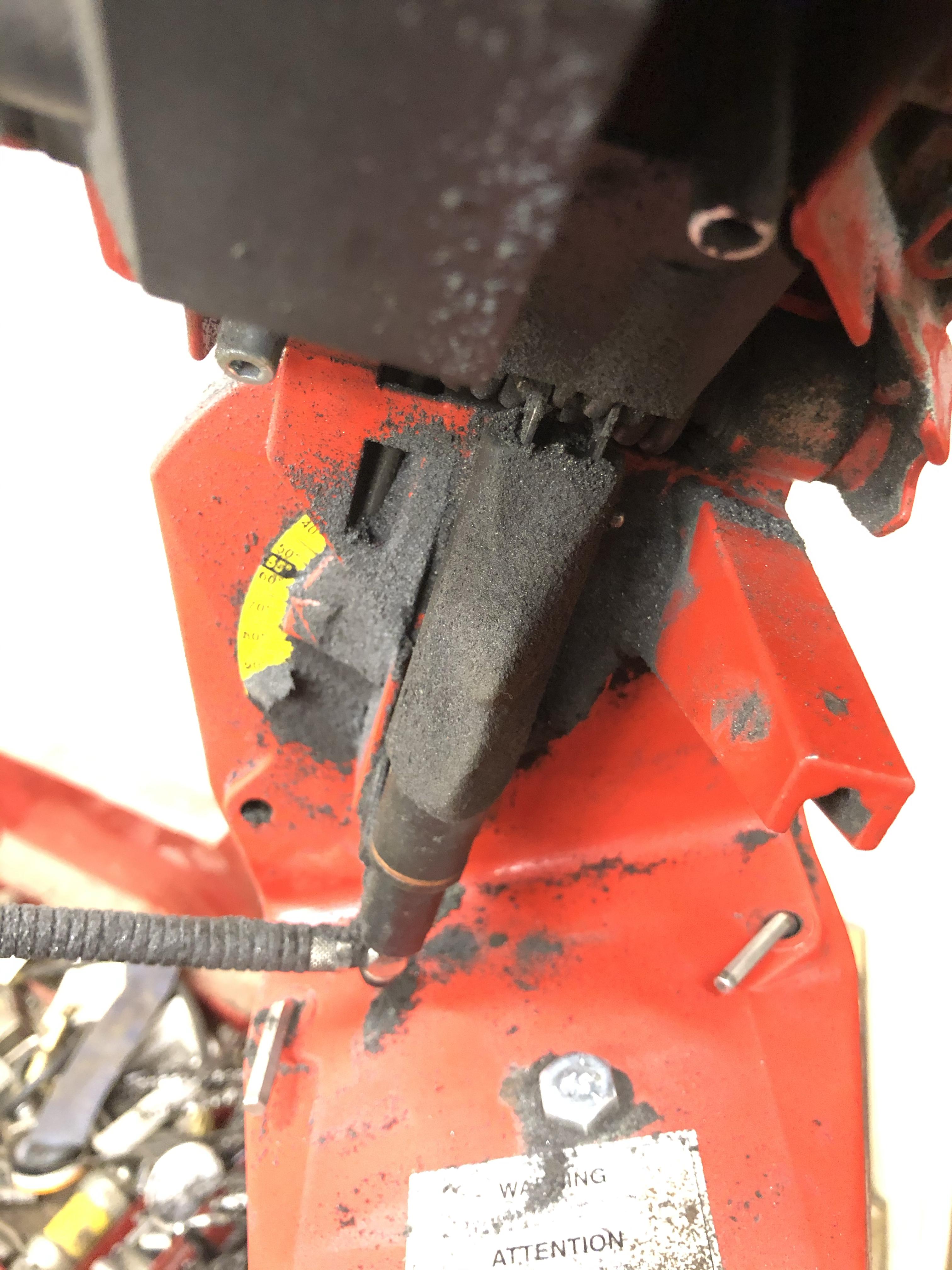

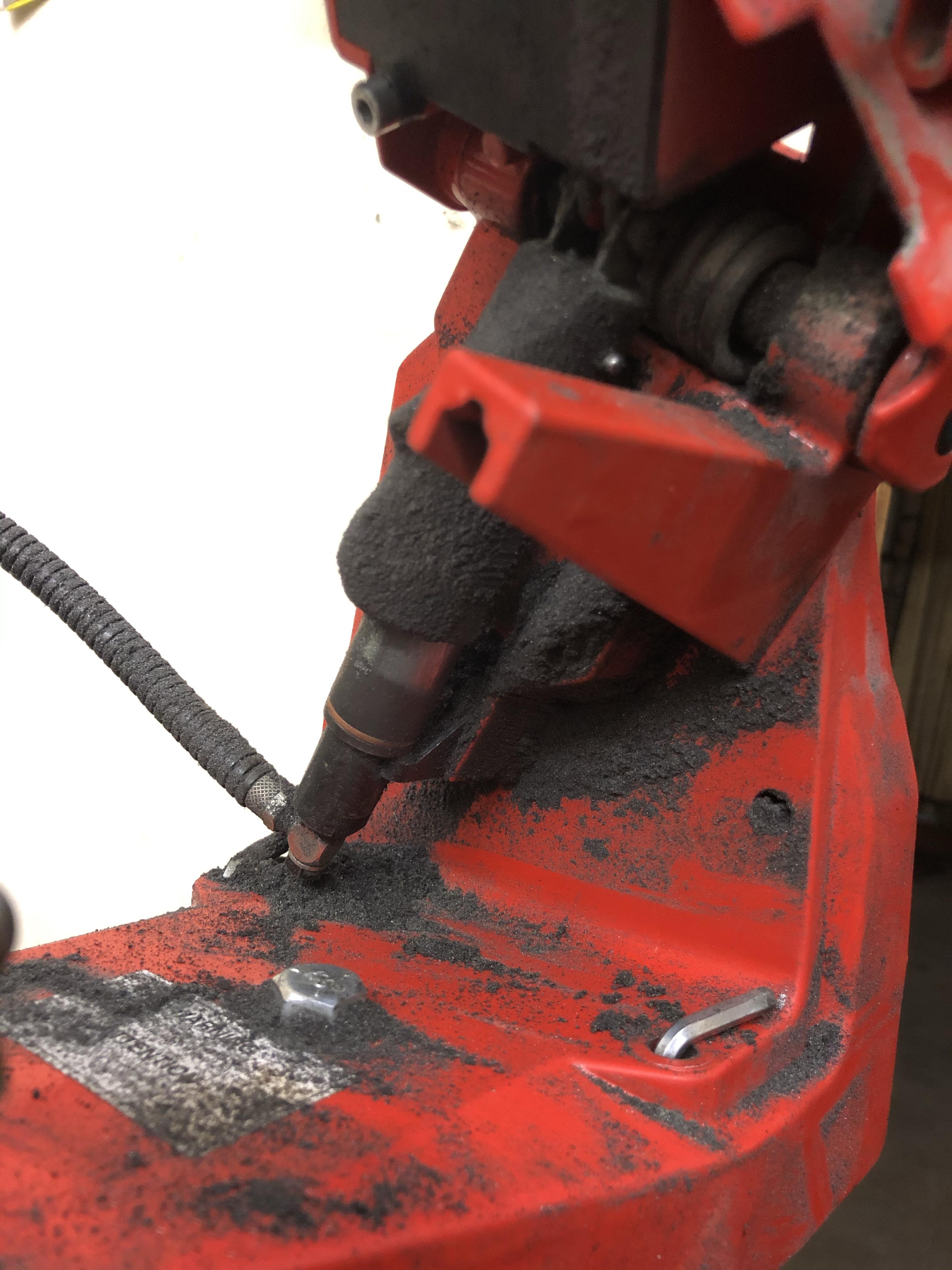

I got it working again. All I needed to do was put the pin back, but it was impossible to do without some disassembly because you can't see what's going on inside the sheath.
I took a snap ring off the top pin and removed it, then removed the sheath. The piston had rotated a bit so there was no I was getting in that hole by blindly poking around (that's what she said?)
Putting the top pin back in was not as easy as you'd think. The lock rings don't snap into a groove. They just sit on a smooth pin. You have to slide them on from the end. I wouldn't think that has much lateral holding power... but what do I know.
