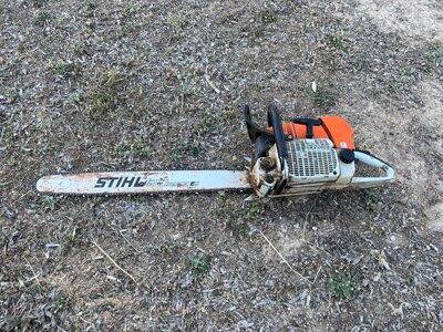

Good afternoon guys,
I like to inspect chainsaws and build them up from the ground up, but there are very few of them that I use, once they are finished they tend to stay put.
Today I drained three of them of old mix, new mix tomorrow before some test cutting.
Plan is to let some of them go locally, buy a couple of 5xx's.
Always liked the 346's and 242's short powerheads so they will stay.
