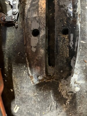

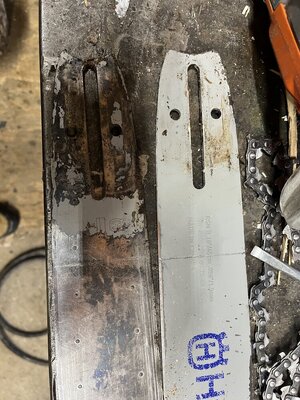

Found something interesting.
New bar above, old bar below. Both Husqvarna bars.
Much more adjustment range with the old bar.

Both 18” 0.058, 3/8” Husqvarna bars. Both roller nose but the old one did not have a replaceable nose and the newer one does.. The new one came on my 2021 562xp. I have a third 18” Husq bar on my other 562. Will have to compare it too. I think they are all Oregon made bars, before Husky made the switch.
I changed bars and got the last few sharpening out of my chain. There were 4 teeth missing by the time the first rivet gave up. New chain tomorrow. Woohoo!
