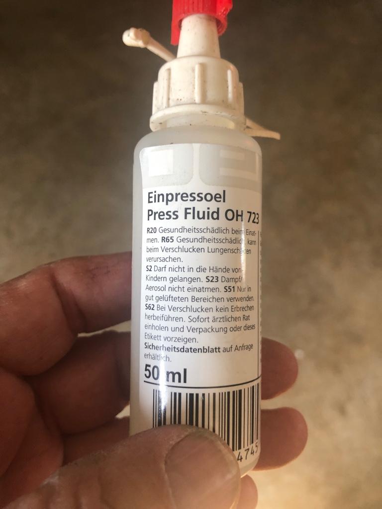

Stihl also has this. Makes assembly of hoses, rubber parts much easier.

I find that using strawberry flavored KY Jelly has been known to work.
