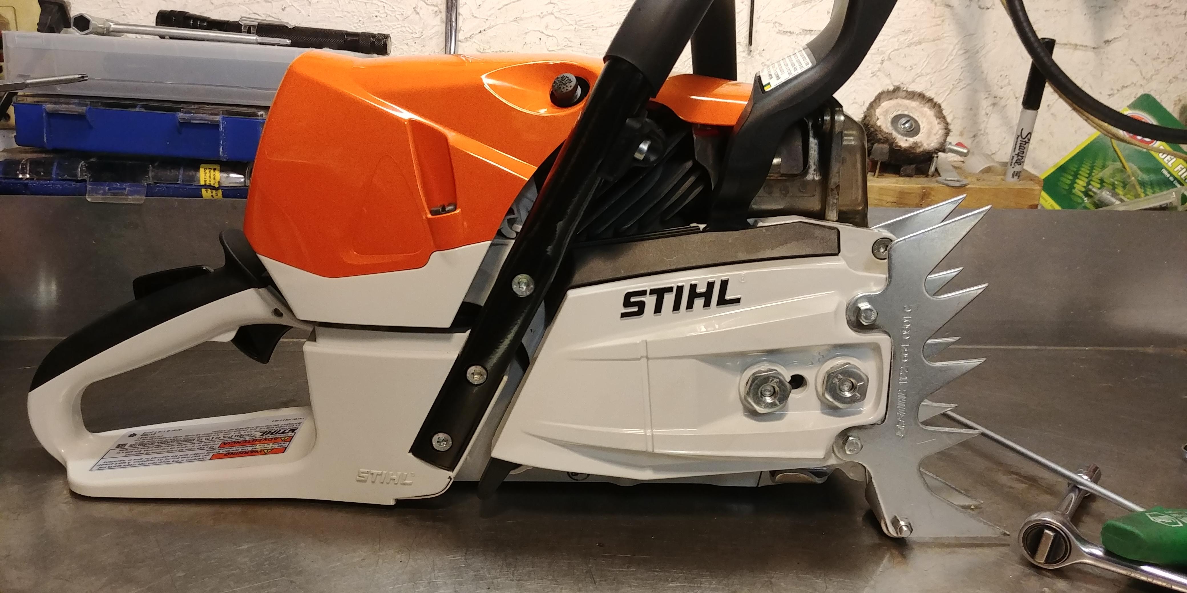

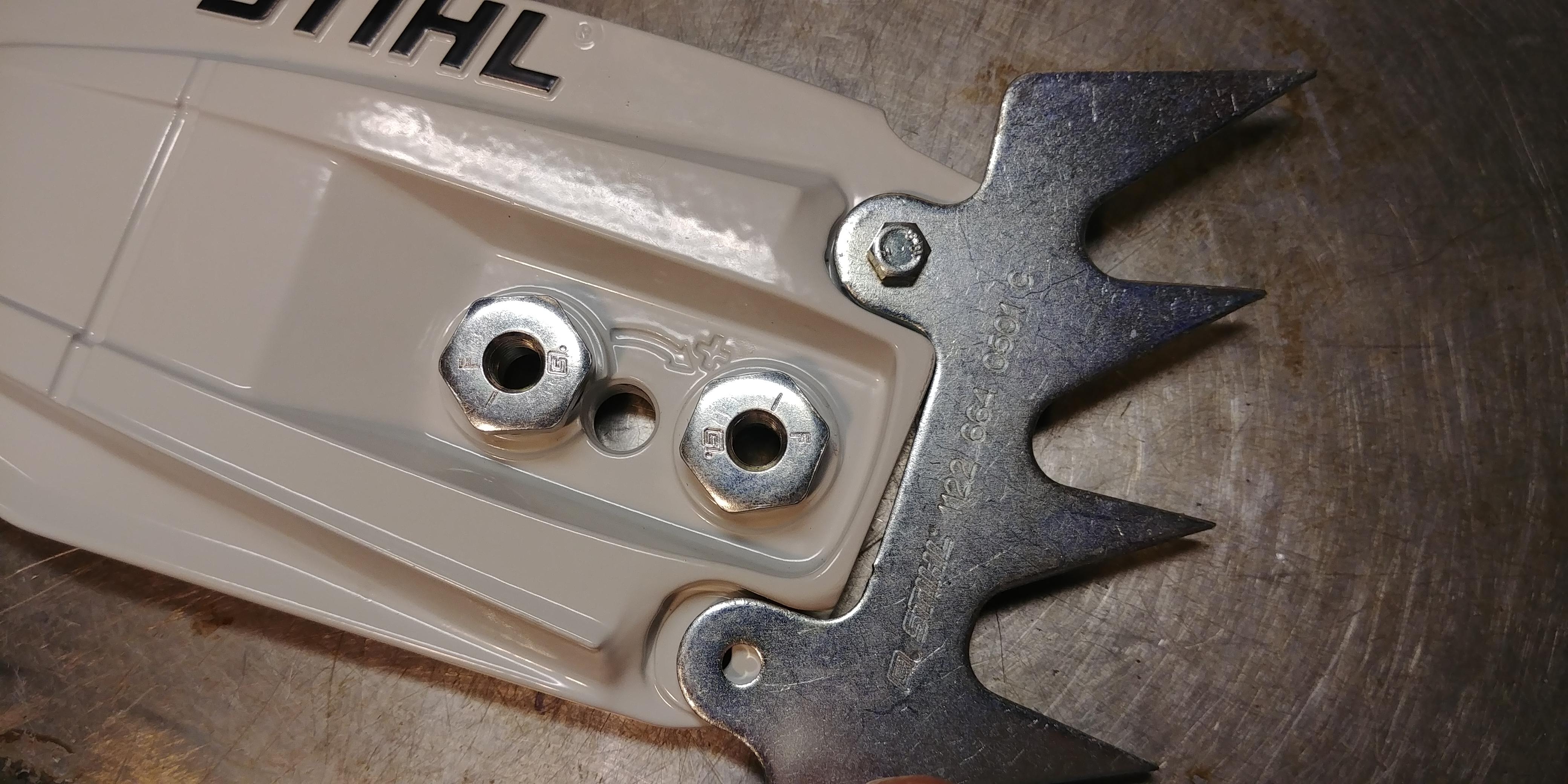

Do I have the correct outer spike fro my 462? It's not fitting, I can clearance it obviously, but. The part number is 1122 664 0501.

You have the right one. Just gotta give it a rub and it still lines up with the roller. No need on the west coast cover.
They make an outer that lines up with the stock inner if you like, I'm a fan of the 064 dawgs on them for hardwood personally.

Thanks for the info, I also have the inner spike. At sole point I may pick up the other cover just because, may give the 064 spikes a go, I did like those when I was messing around with a 064 [emoji111]
There's no issue with the west coast cover when you add the larger dawgs..it's weird..I know.
I like the shape of the bottom of the dawgs on the 064 set. They don't bite as hard, which obviously isn't needed for hardwoods.
That outer to match the stock inner is cheap.

When I initially ordered the kit my dealer only got that outers spike, but I said no I wanted the whole kit with the roller catcher lol.
Anyway about a minute grinding and she's together, no biggie I was just wondering if I got the wrong one or not. Thanks for the quick response.
Looks much more usable, I run into a lot of gnarly old trees, so I like the bigger more aggressive spikes. And yes they look cooler.[emoji123]

I think that is the wrong spike. My guy got me outer spike # 1142-664-0501 for both my 462s, fit w/o any issues.

The 1122 664 0504 (066) is replaced by 1122 664 0500 on the 064. There is no complete kit with both spikes chain cover and roller catcher. You can buy a kit for the 064 with the large sprocket cover, the outer spike and the roller chain catcher (1122 640 1711) used for 064 R and 064 RW.
I thought the 0500 is replaced by the 0504?
The 0504 is standard "small" spike for the 661s. From the pictures its the same thing though.
