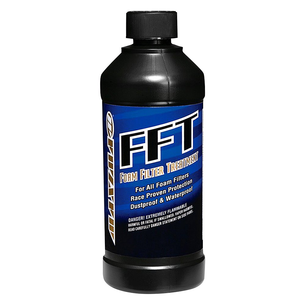

The white is denser for when you generate more fines. I'm not sure what the "spitback" thing is on a 460, so IDK. Be sure to get a BOTTLE of filter oil (not a spray can), too. I use Maxima oil like the stuff below because that's what my local shop carries, but I'm sure any foam filter oil will work.

Thanks! I have a bottle of BelRay I’ll use. Do you clean them with gasoline?
